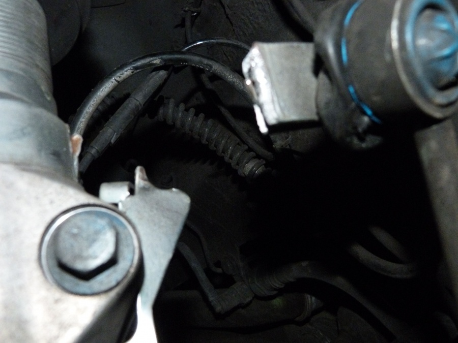

Hello all
tonight when I was backing my car out of the driveway I heard a loud cracking sound like something broke or snapped. I was too afraid to drive my car so I jacked it up and this is what I found!Name:  P1020724.jpg
What you are looking at is my left front wheel looking straight into the wheel well. And as you can see, the part of the droplink that attaches to the coilover is dangling freely. The metal that connects the droplink to the coilover has been completely ripped off!Name:  P1020727.jpg

my finger is where the tab that holds the droplink used to attach to the coilover Name:  P1020742.jpg
I'm really upset right now since Bilstein has a history of denying warranty claims. I purchased these coilovers from an authorized dealer and had a very experienced installer (somebody who has installed Damptronics for many 6speed Turbo owners) so I have no reason to believe that it was an installation issue. Help!!!

unfortunately it is not as simple as replacing the droplinks. the part that the droplinks attaches to on the coilover side has been torn off of the coilover body.

Your problem is that h&r sways are too stiff. They are the only solid sways on the market. I had the same problem with my BMW and kw housing. Kw did honor my warranty claim but only because of a relationship I had with the distributor. If you had stock sways or even eibach sways it might be different. Good luck.
Old Dec 11, 2011 | 10:35 AM
NorthVan's Avatar
Joined: Jan 2008
Posts: 8,875
From: Vancouver
Rep Power: 684
I had my Bilsteins with H&R sway bars. They weren't a problem for me. Recently removed them from my car when I traded it in, perhaps it was a manufacturing flaw, or a minor collision that took some time to finally break the CO?

In my case the problem was NOT with the droplink. The droplink is intact. It's where the droplink attaches to the coil over where the failure is. Which is very disturbing since Ive never tracked the car and I was just backing out of the driveway. I really hope bilstein steps up to the plate on this.
