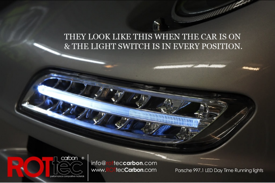

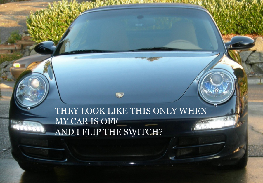

I am confused and need help with my new DRL lights...
Can anyone figure this out? Am I missing a part? So the DRL's are plugged in. The only time I can get the LED bottom row of lights to turn on is when the car is OFF & I flip the switch over one notch past Home (the fogs) When the car is ON only the Daytime running light works? In every position only the little middle light work again when the car is running.
Im I missing something?

Yes, only the middle bar will be on. If you want the entire bottom LED row to come on you have to turn on your fog lights by pulling on the light switch.

Thats because you did not buy DRL's, you bought an exact replacement of your OEM lights that use LED's instead of regular bulbs..................
We tried to clear up this confusion in other threads. ROTtec calls them DRL because in a Canadian spec car (which comes with OEM DRL function) you are converting to LED DRL function.
The good news is, it's a pretyy easy fix. Search the threads for my write up on installing a Dectane DRL module. The cost is about $50 and can be done with no special tools in about 1 hour. Then you will have true DRL function with the bottom row of LED's.

You need the TFLM03 module to get DRL functionality in the US
