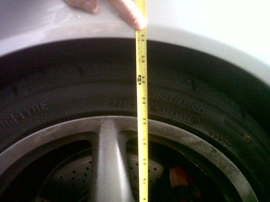

Northvan... You inspired me to get my car as low as yours lol. I had low pros put on today and slammed the crap out my car lol. Ill post here are some pics
if tire sits higher than edge of a fender you got it too low for stock front arms to work properly, they are no longer at proper angle. you need either to get cup car upright/hubs for that or go with all adjustible arms and get steer-bump toe arms too (which should be custom adjusted at the shop). to keep thing normal distance from floor to fender endge should be 25.5-26" and you should have at least half inch or inch of a gap to fender if you look at your tire top from a side. yours does not seem to have it and it will affect ride negatively.
see attached photo. my car could be lowered half inch more in front but it is set to have 1" of a gap and it is at limit of where stock front control arms are still close to 90 degrees between them. front is at 26" from ground to fender, rear end sits half inch higher at 26.5". it is gt3 suspension, to go lower with car working properly you need cup car parts.
