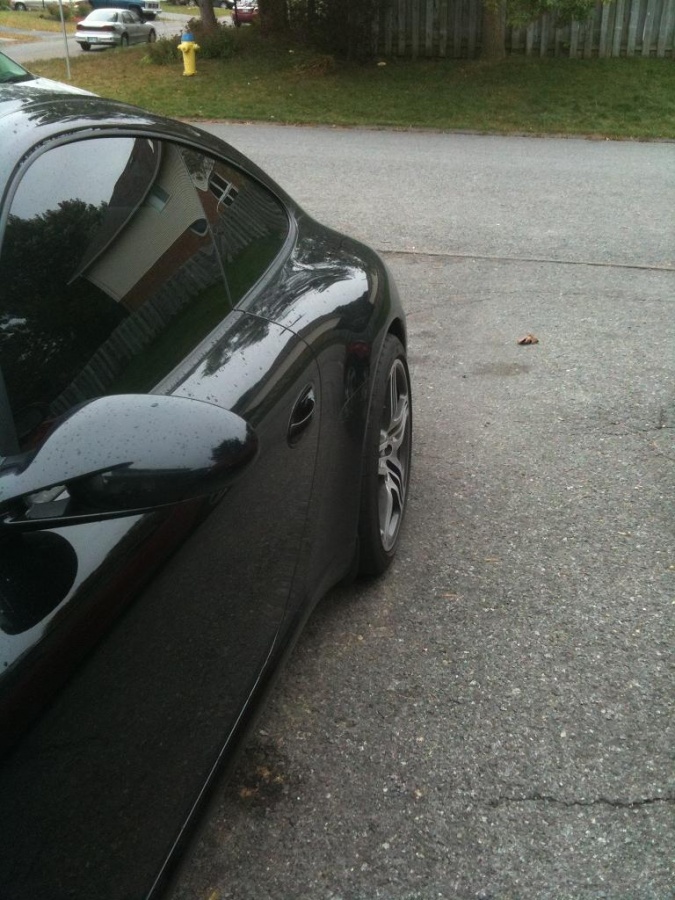

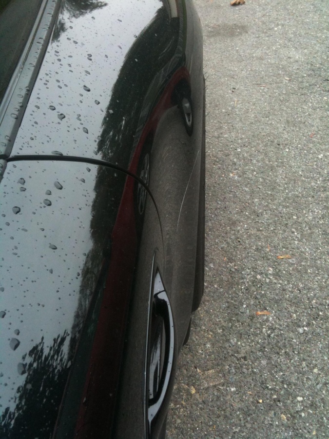

Is the 996 WB wheel 11" wide like the 9997s? I run wide body wheels and 5mm spacers on the rear of my 997 C2S with no rubbing. I'm at an effective ET46 with 295s...aggressive for sure and sticks out ever so slightly. I'll try to find pics and post them. Many people asked what I changed on the car when I put 5mm spacers because it looked "meaner". I tried 7mm spacers and I took them off instantly...incredible what 2mm did.

23mm was only a visual problem for me. It reminded me of 70s muscle cars and low riders with the wheels sticking out...obviously I'm exaggerating but as I said, unreal how 2mm made a difference.

Turbo wheels with 5mm spacers.

Can you show some pics from behind....it also looks like you have stock suspension.

I don't have any pics from behind and I won't be able to take any since the car is in storage.
