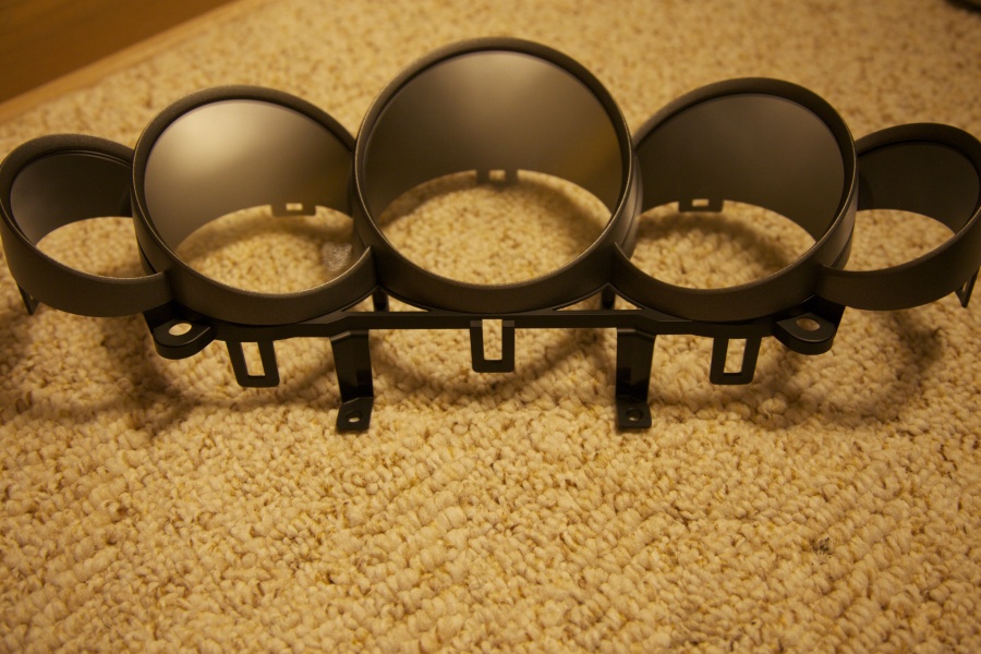

Hopefully this will help.
Removing the gauge face is a little difficult.
First, remove the screws behind the cluster. The grey part holds the clear acrylic lenses, and the black part covers the actual instrument cluster. They are two halves of a shell, and are held together by several plastic clips that will break if you are not careful.
Cover the acrylic face with something that won't scratch.
First picture represents the front half of the gauge cluster.
Notice that the blue arrows indicate plastic clip retainers - there are 8 clips total.
Red arrows indicate inserts into the back half of the gauge cluster.
Old Mar 12, 2012 | 08:18 PM
bbywu's Avatar
Posts: 10,774
From: OR Room 5
Rep Power: 1007
Front half, bottom view.
Old Mar 12, 2012 | 08:20 PM
bbywu's Avatar
Posts: 10,774
From: OR Room 5
Rep Power: 1007
Front half, top view
