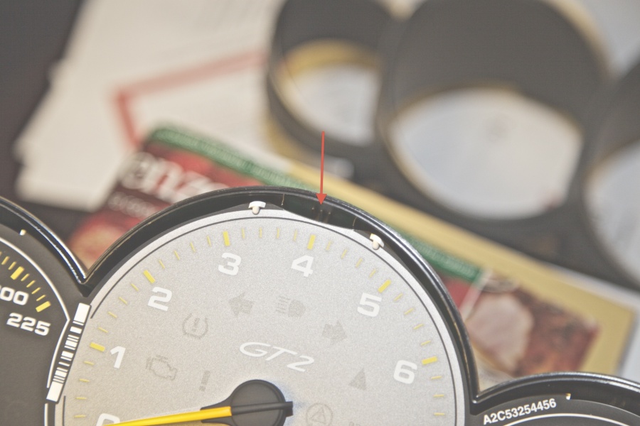

You need to carefully pry the plastic clips to get them to dislodge.
Top clips are very hard, as they are hidden. I increased the brightness in the next photo to show you that the engagement point is from above. The plastic wedge is on the upper part of the rear gauge housing.
It is difficult to disengage all three without breaking one.

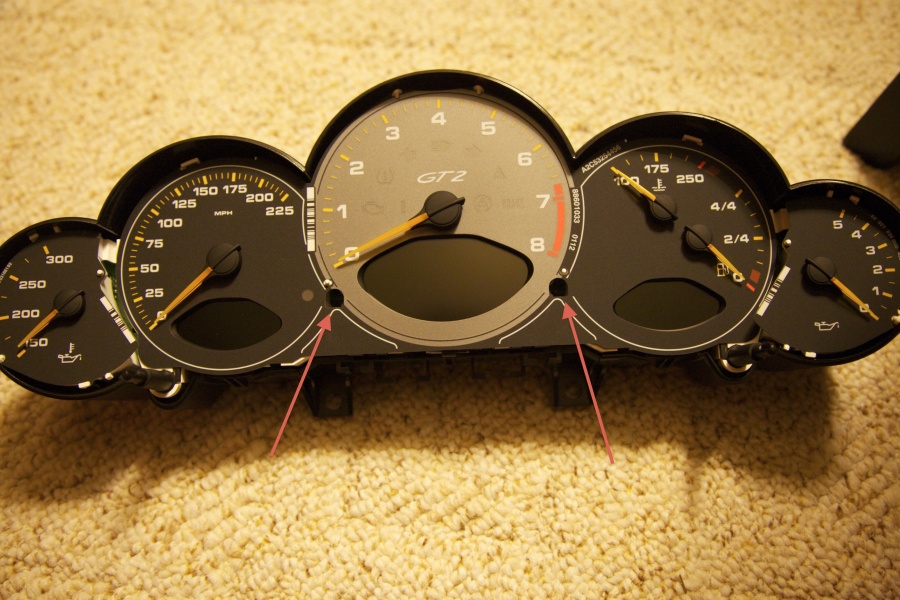

Next photo shows where the inserts (red arrows from first pic) slide into:

Needles can be removed without tools - just don't wiggle too much. But gauge face overlays will not come off without cutting the rubber grommets under them.
