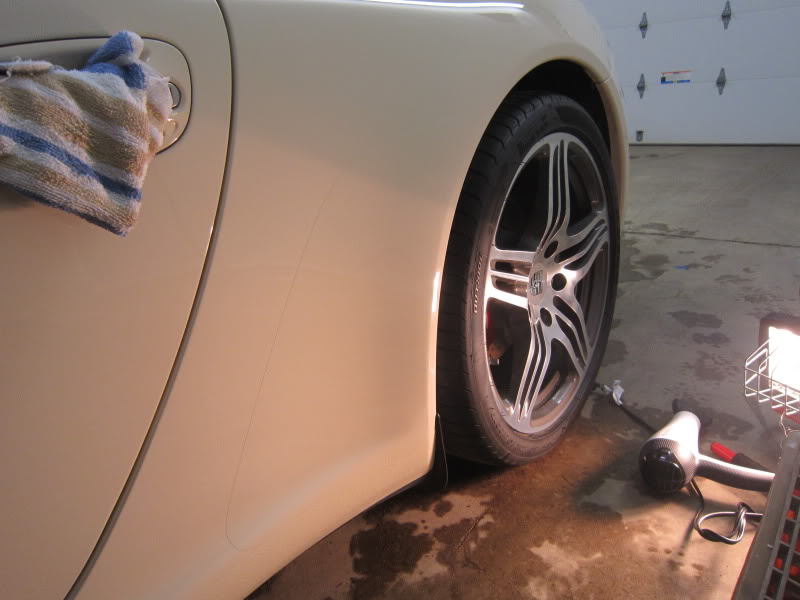

Did both sides... Just completed and there are no bubbles, finger prints, etc.... My concern is if it will develop something overnight...It may appear there is something in the pics but there is nothing. The white was a little hard to see while working too. Those are only my second and third ones I ve ever done, so it appears it can be done pretty easy (as many of you know from experience). I used all the above tips including doing a wipe down twice with alcohol/water to ensure a clean surface. I m sure I ll be going into the garage all night to check them ...Thanks.

Well done!

Wow, the second picture you can't even tell is there! Great job!!
