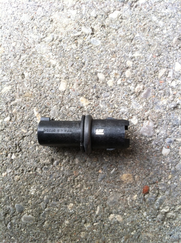

Crap... guys I need your help!
The pin inside the foglight bulb connector is broken (see attached pic for what the connector I'm referring too)
Does anyone know the part number or where I can get it online?
