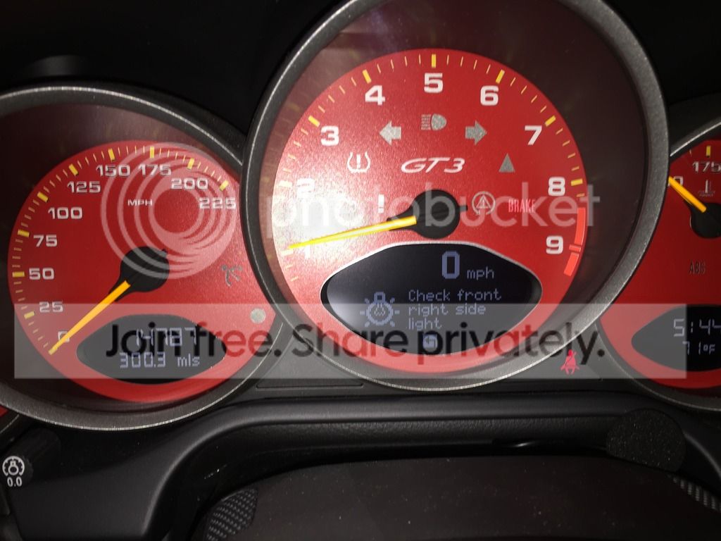

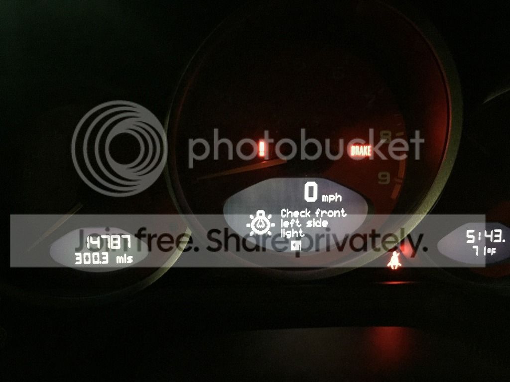

I installed a set of LED DRL's from eBay's seller Fishcake321 which is a reputable seller. I installed the lights per the installation guides from this forum and I'm stumped. From the troubleshooting that I've done, the wrap around DRL light bar is throwing the Check Front Side Left and Right Light warning on my dash.
I pulled the lights out and plugged the OEM bulb into the socket and boom the warning is gone. The seller said there isn't a need to add a resistor to the light.
Has this happened to somebody else?

I bought the fvd led lights front and rear,. The rears worked fine but like yours I have the exclamation mark and error messages for burnt light on left and right. Any suggestions

Yes, happens on mine too. I don't get the error message the first time I start the car in the morning, but get it every tine thereafter throughout the day. Error is sometimes only for 1 side and sometimes for both. I did a test with the resistors, but they got so hot so quickly that I opted to not use them and just live with the occasional error message in order to have the center bar as a DRL. If you find a good resolution to the error, let us know.

Originally Posted by kotykb
Yes, you need resistors, I had the same error.
FYI The resistors work and eliminate the light error. I used electrical tape on the connections to ensure they don't loosen over time. The resistors do get pretty hot but they're dangling in an open cavity in the front bumper, what's the risk?
I had resistors in the rear, there is plenty of space back there, nothing is dangling.
