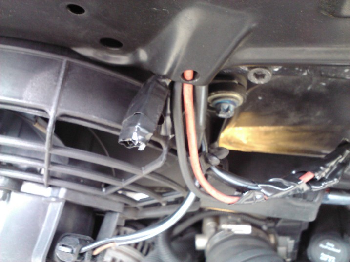

I am unable to get great pictures of the modified harness at this time. I live in a high rise downtown and the association is very strict about anyone doing any work on their car in the garage (big pain). However, the picture below is as much as of the harness I could pull out without breaking out the toolbox. Generally, everything you see pictured is hidden within the lid for a much cleaner look.
*Disclaimer*The following process is based from memory of a quick fix I did several months ago, so please be kind as it may not be 100%
With the decklid open, you will see the harness traveling up the passenger (right) side of the lid, underneath the assembly plate. Unplug the bay light and fan. Remove the hex bolts securing the assembly plate inside the decklid. I believe there are 9. Remove the assembly plate. This will expose (among other things depending on the model of your spoiler) the harness. You will recognize the bay light plug, the fan plug. And third brake light plug. You will also see two other wires with switches at the end. I installed a cheap wiretap (I believe they came from Autozone) on each side of the switch and installed a jumper between them. That’s it. When reinstalling the harness and assembly plate, be sure to take notice of the location of ALL of the wires on the harness. It is easy for excess to get very close to the cooling fan.
