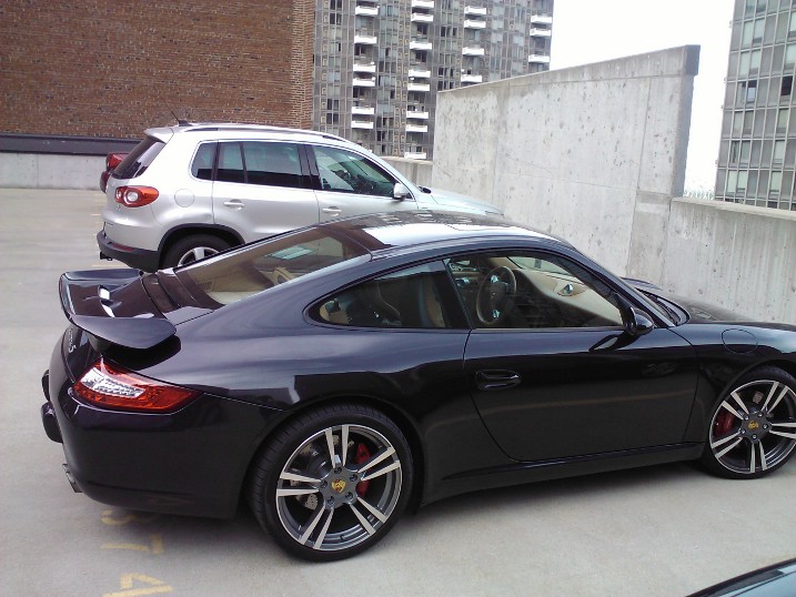

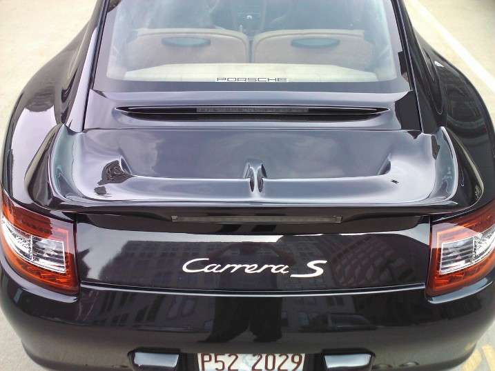

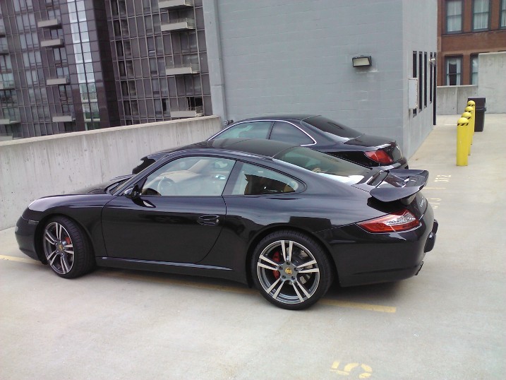

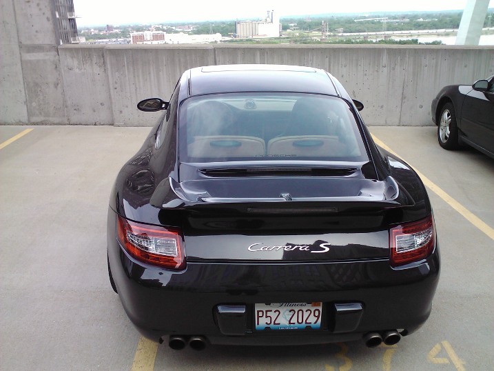

Pictures of the Whaletail:
Old May 11, 2012 | 04:35 PM
Scoper's Avatar
Joined: Mar 2010
Posts: 578
From: Portland, OR
Rep Power: 42
Scoper has a spectacular aura aboutScoper has a spectacular aura aboutScoper has a spectacular aura about
BEAUTIFUL! Love it.
