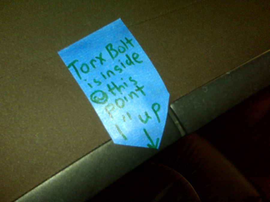

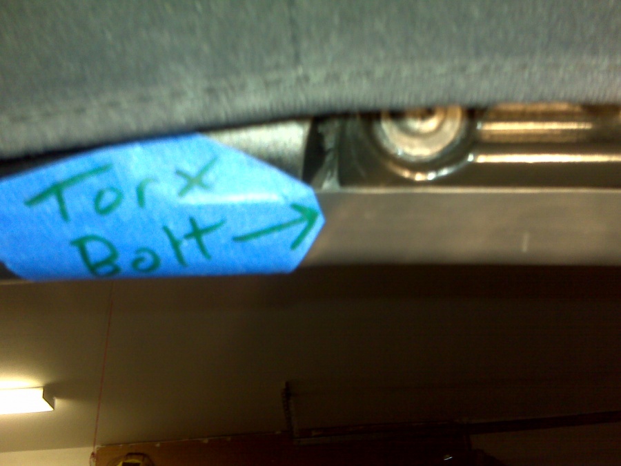

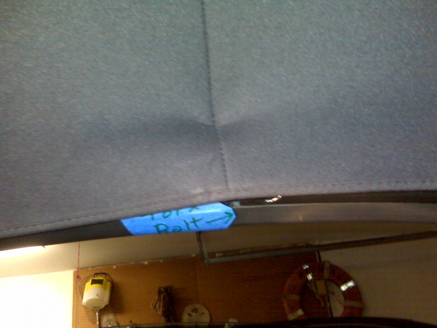

check the the two Torx bolts (t-30) on both sides of top
see pics (na011)
also (per na011)
Also try lubing the joints with "DuPont Multi-Use Dry, Wax Lubricant". You can buy this at Lowe's.
http://www.webbikeworld.com/t2/motor...n-chain-saver/
Use 303 Aerospace Protectant on all the rubber parts. The 303 is a great product. I use it on all vinyl, rubber & leather. The 303 High Tech Fabric Guard is good for your top. Both protect from UV rays.

Thanks for the tips. I'm wondering if mine might not be the driver's seatbelt reel. I have to investigate a little bit more. But if they replace the headliner, as I hope they will, or at least remove it, I would guess that would be a good time to have them tighten and lube everything in the mechanism.
Great pics to show the bolts, thanks!
