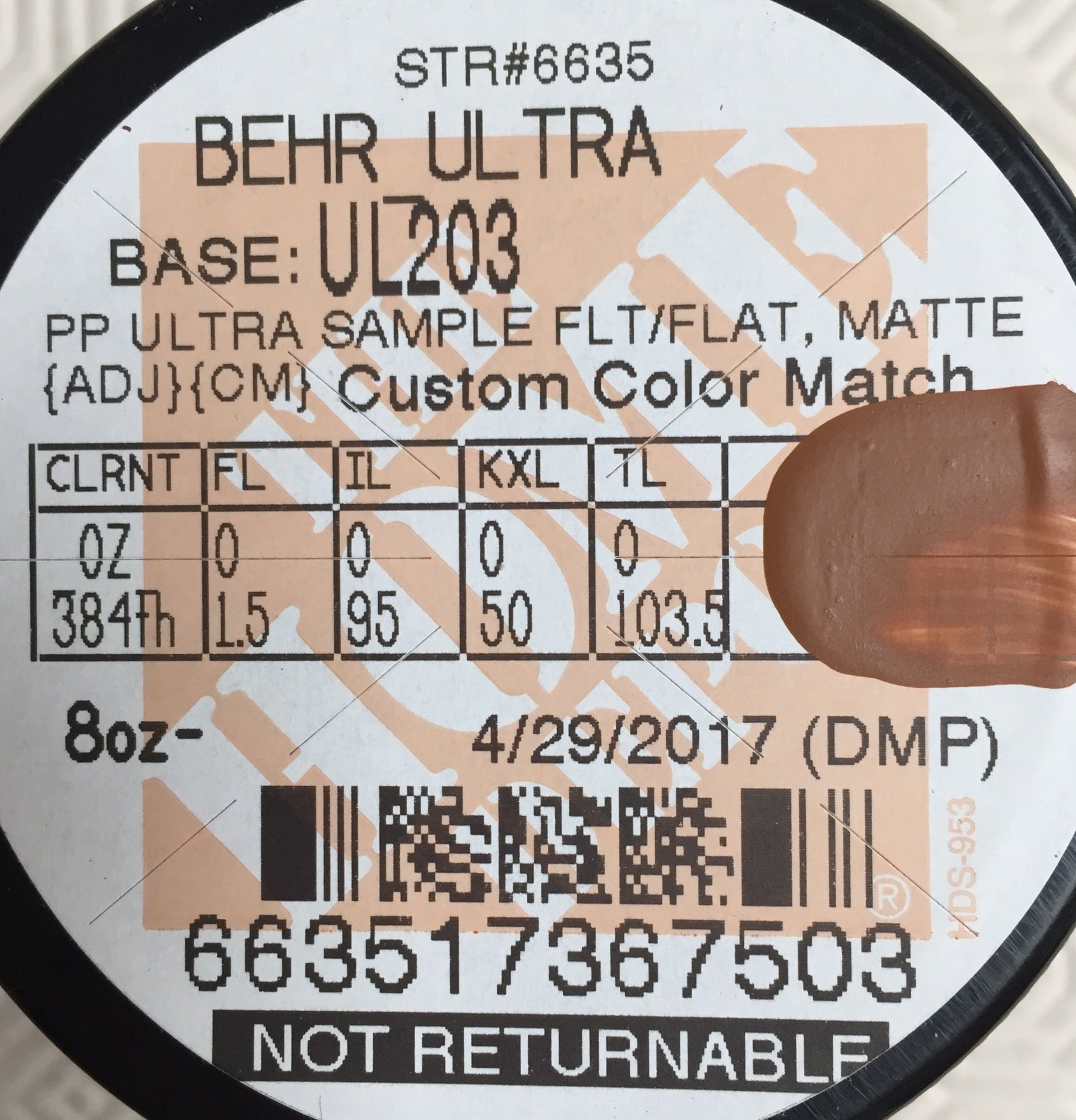

Natural Brown for 997 interior
This was done at HD on this date. Paint formulas change and the codes I got are different from the codes for the same color posted here in '12. The match is perfect.
