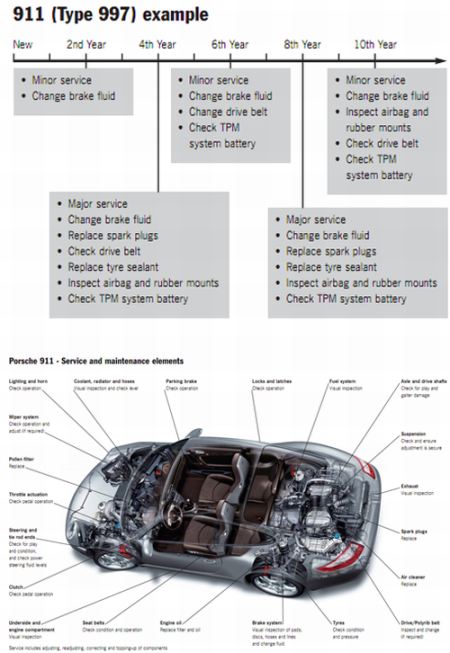

Old Jul 11, 2012 | 05:22 PM
Mikli's Avatar
Joined: Mar 2008
Posts: 344
From: Canada
Rep Power: 40
Mikli is a splendid one to beholdMikli is a splendid one to beholdMikli is a splendid one to beholdMikli is a splendid one to beholdMikli is a splendid one to beholdMikli is a splendid one to beholdMikli is a splendid one to behold
911 (997 since Model Year 2005)
Engine oil 20,000 miles or every 1 years
Spark plugs 60,000 miles or every 4 years
Oil-filter element 20,000 miles or every 1 years
Air-filter element 40,000 miles or every 4 years
Fuel filters are maintenance-free
Coolant does not require changing
Brake Fluid 20,000 miles or every 2 years
File Type: bmp
