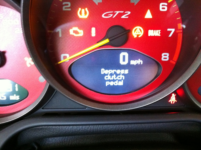

As far as depress clutch, this is what I usually see in my GT2.

Scenario 2, put the key in, turned to ignition 1, everything lit up. Clutch in, Nothing.
Cycle key, holding clutch, nothing.
Still holding clutch, cycle again, nothing. Got "Depress Clutch"
Released clutch, removed key.
Inserted Key, pressed clutch, started right up. I want to go for a ride but waiting for the weather to dry up.

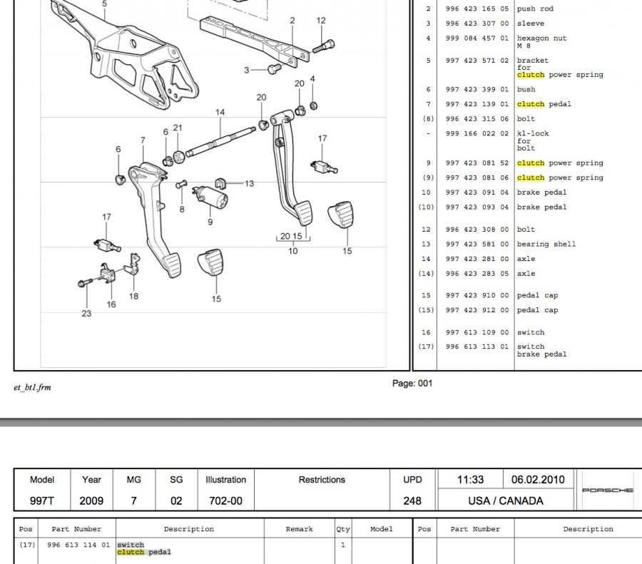

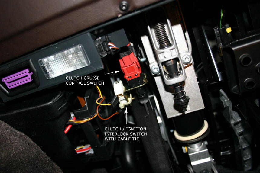

Your car may not have sensed the clutch depression - I have had a situation where the sensor for the clutch depress did not allow the engine to turn over. My guess is your KESSY/PAS unit is fine.
This may help:
http://forums.rennlist.com/rennforums/997-forum/532170-starting-after-depress-clutch-pedal.html
and
https://www.6speedonline.com/forums/997/230793-depress-clutch-message-car-wont-start.html
It's a pretty easy DIY.

It's either the clutch/cruise switch, or the clutch/ignition switch.

And it happened again, will order the switch online and will replace it this weekend. I noticed it only happened when I put the key in and turn it very rapidly to start. Normally I turn the key, let the lights light up, the K40 mobilize then turn the car on, no problems then. If I rifle the start, get "Depress" message.
Thanks again bbywu for making it easy.
