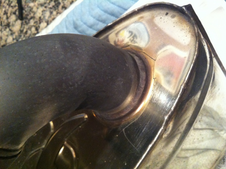

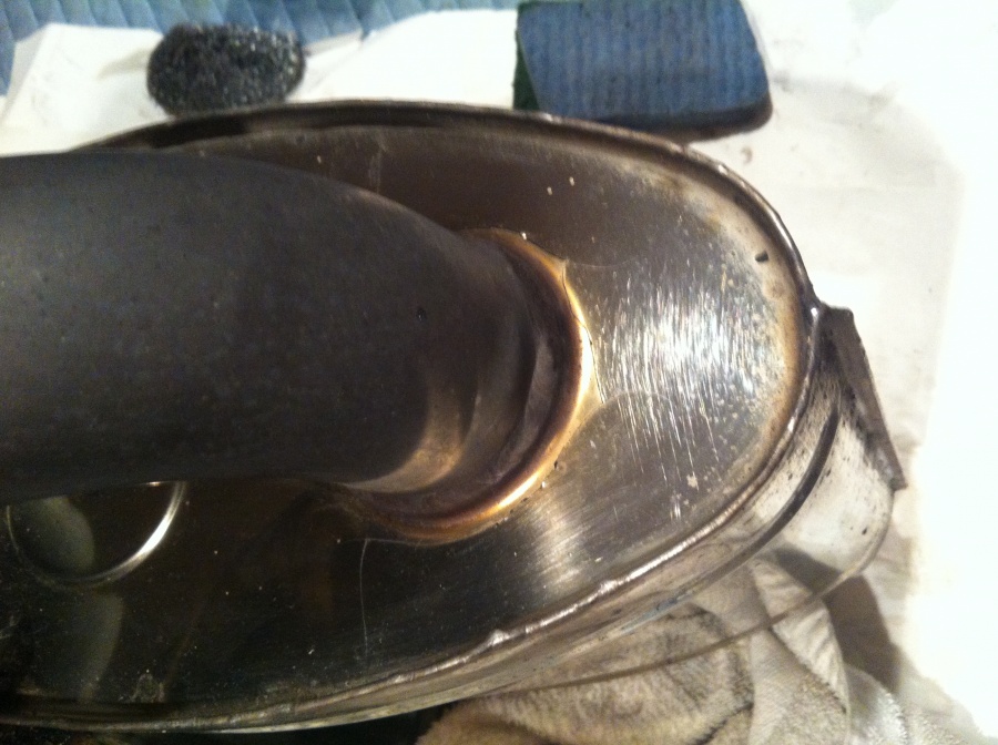

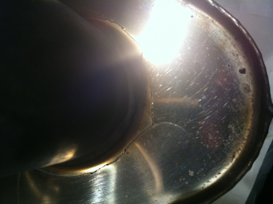

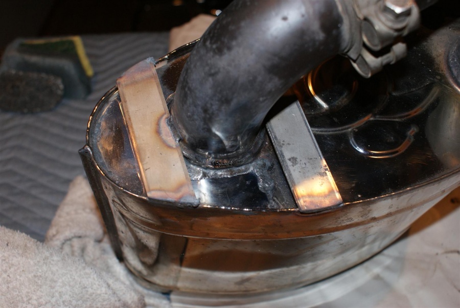

Got the exhaust out - easy enough to do. Cracks much worse at the top of the muffler where I couldn't see it on the car. Word of warning - this went from a slight buzz early last week to intolerable today. When they go - they go in a hurry. If I waited much longer it could be a more difficult repair.
As a point of reference - these cracks are around the pipe going to the exhaust tips - not the pipe coming from the cat. I though this was interesting b/c I could see how the cracks could develop on the pipe from the cat if the exhaust wasn't installed/aligned correctly (although it doesn't look like there would be many ways to screw up the install). This wouldn't be the case with the pipe going to the exhaust tips - that pipe doesn't attach to anything else on the car. Basically free floating.
I'll run it over to my buddy's factory in the morning and see what his guys say about welding it. They may have some ideas to reinforce the area or possible figure out some support system to tie the two pipes together.

^^ That's a material issue. Ridiculous. The only hope for Tubi is that's a problem they've sorted in current production products.

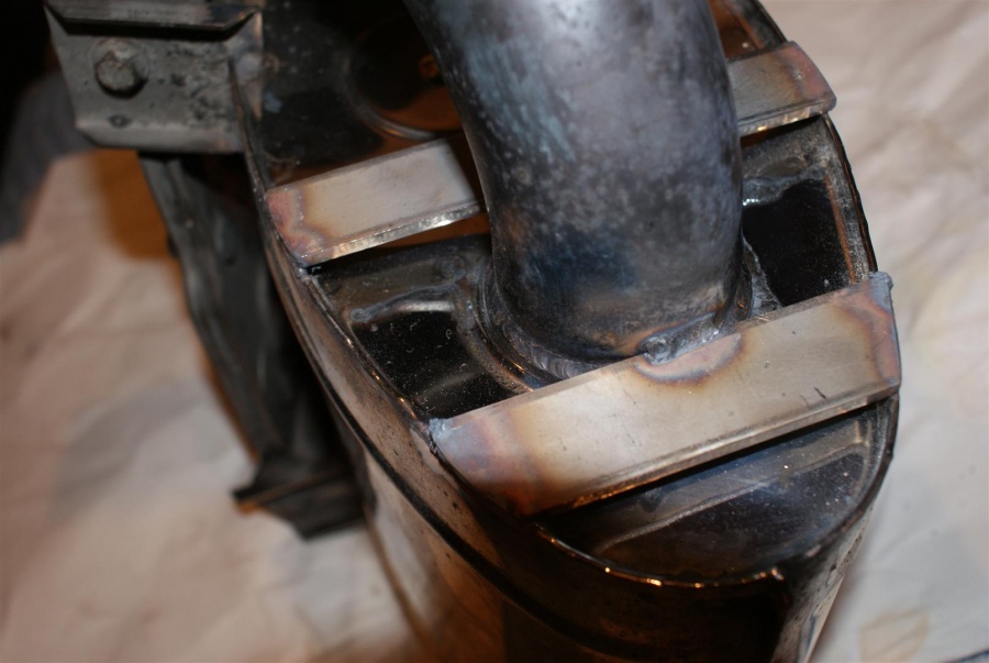

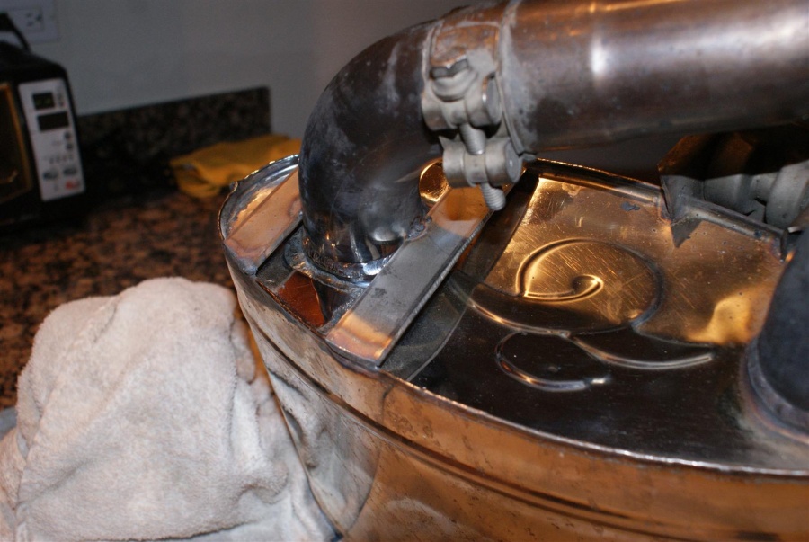

So here's the fix -
- welded all the cracks
- added some additional stainless supports
It's much stronger than before. I'm also going to add a high temp shim of some type between the two pipes (where I'm holding the pen) and a stainless steel clamp. This should better support the exhaust tip that clearly seems to be an issue for Tubi. (I didn't want to weld this b/c I'll lose any adjustment of the exhaust tips.)
Should have it on tonight. Will be nice to have it fixed. Guessing it is a matter of time before the other side fails. Hopefully the shim/clamp which I'll do to both sides may prevent that.

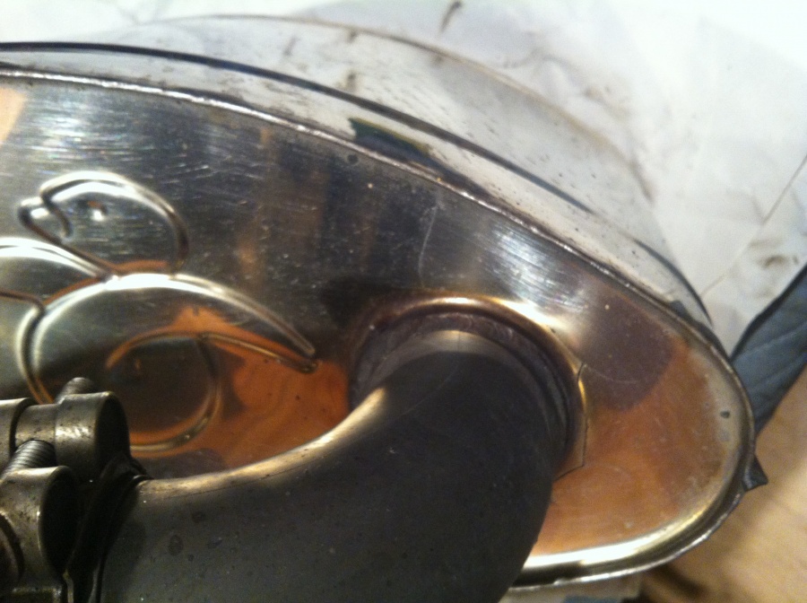

I can't help but notice that the lip and bottom side of the muffler (especially the third picture from your earlier post) looks like it was banged up at some point. If that was the case, perhaps the stress from the impact caused the cracks and separation of the weld.
Quite possible that the previous owner backed up into something and banged that one side. Two of the major features for the Tubi mufflers are 1. they're incredibly light and 2. with such a light muffler, one can expect no drone. So, for these reasons, I would agree that they may be a little more delicate than stock and some other aftermarket cans, but like everything in life, you have to know what you're getting into and why.
I commend you for your ideas to strengthen and improve the product with your repair.
Best of luck and I'm sure you'll be pleased once you get the muffler back on your car and start driving it again.

^^ to me, those cracks look like fractures which have developed over time. They don't look like they were the result of an impact. Hot/cold cycles, stress, and fatigue. The material didn't cope well.

Not sure what you are seeing - probably a reflection. There isn't a scrape, ding, or dent on the exhaust from any type of impact. Would be pretty obvious with the high shine polish. The 3rd pic from my earlier post is also the high side of the muffler - not the lower portion. Nothing is getting up that high without leaving damage below.

Yes - exhaust is back on. Sounds great once again and not embarrassing to drive. Glad the exhaust is simple to work on with these cars. Probably had it installed in under 20 minutes.
Treated the car with a wash after the repair. May have found a new favorite car wash place. After initially cleaning the rims they rolled the car forward to ensure the calipers were clean behind the spokes.
