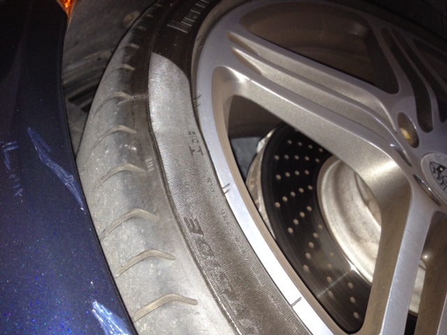

sidewall bulge
hey fellas - happened to notice this slight bulge on the front pass side tire in the sidewall, P-0's
they have about 7500 miles on them. any thoughts on the seriousness of this?
thanks

I would immediately take it (slowly) to the place you bought them and have it replaced. No tire anomaly is good (or safe in my mind).

It would appear that the inner wall of your tire is damaged so the air is pushing a "bubble" out. These can happen from a hard contact to a curb, a railroad track or alike. At least it doesn't look like the wheel is bent from the pictures. Or it could be a flawed tire from the outset. You've already gotten good advice - take it in and get it replaced. Drive carefully!

thanks to both of you for replying, much appreciated. this is my DD and i take my kid to daycare, so agree, wont risk riding too much longer and will get it replaced.

It looks the sidewall layers are delaminating internally and allowing the air to push out to the side.
Like someone said, this could be caused by hitting something or just a tyre defect.
I would highly agree with everybody to get the car to a tyre shop asap.

I'd replace it.

Make sure you have the tire shop check the wheel for damage prior to having the new tire mounted. If the bubble was caused by an impact, the wheel was probably bent. Wheel shop can repair the wheel and mount and balance the tire for you.

thanks and will have them check rim. no obvious to my eye, however may be subtle bend in rim which unless straightened will probably increase risk of tire damage again.
Correct. When it comes off the rim you will see damage to the inner liner of the tire. Replace it. It's only going to get worse.
