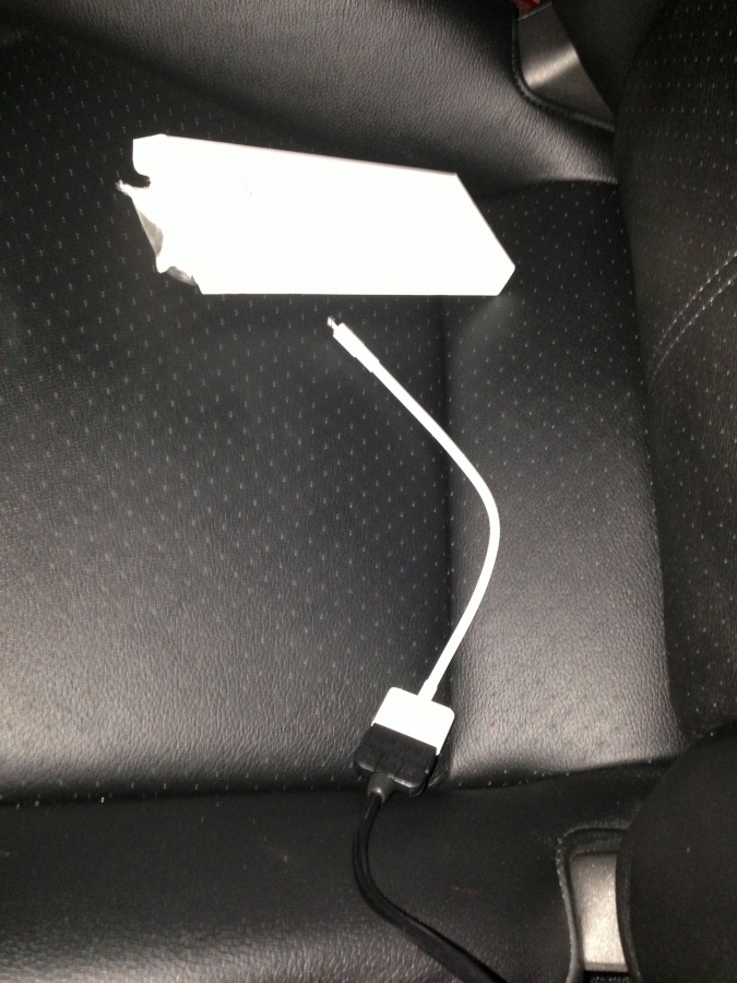

Test confirmed
Today, I received my Lightning to 30-pin adapter .2m length. Works fine and using this instead of the other Apple adapter does not make me take of the phone case. Nice length if you like to sit your phone on the passenger seat. All functionality works on Radio.

does all that cabling and the phone fit into the center cubby with the lid closed?
