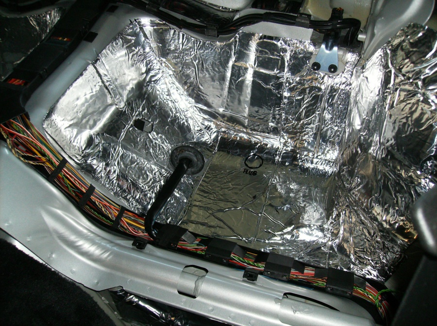

sound deadening material helps alot, you have to take out thr rear carpet and line the seat pan, even up the seat back and wheel well. Every bit you can do helps that much more. It wont make the car silent but I would say it kills it 50%

I almost traded my 997 GTS because of the excessive road noise when on the highways around Dallas...but then I came to my senses. I put new Michelins on a couple of months ago, and that made a dramatic difference from the Pirellis, but that's because the Pirellis were running pretty thin on tread. The car is just fine on normal city streets, but as soon as I get to the longish highway drives, it becomes an exercise in futility to try to listen to the stereo, BT phone call, engine, exhaust, or even passenger. I know the car wasn't designed or meant to be the most serene of environments, but it should be better.
While the 991 is a dramatic improvement on the interior experience, I'm not going to consider one until at least the .2 redesigns come around (maybe with some of the Sport Turismo cues).
I did have someone mention the Dynamat product a few weeks ago, but haven't thought much of it until seeing this post again. Would like to hear feedback or insights to such a project. It appears as though it can be a weekend DIY type of thing. Disconnect the battery. Remove the seats and carpets. Center Console removal??? Cut and apply the sheets. Reinstall everything.
Sound about right?
But what sections of the car would get it? Floor pan (front and rear?). Rear bulkhead and side sections?

I put up a thread like this previously and no one seemed to offer a solution. But now okb's reply seem to offer an option. 50% reduction is good. I just wonder if there is a lighter option im sure that that much dynamat must weight a lot.

Care to elaborate okb on your exercise? Im sure it helped and 50% is tremendous but did it also kill exhaust and intake noise? Did it rduce the sports car feel. Im inclined to believe the 991 went this route and so needed the symposer to put back some engine noise minus the tire rolling noise.
Do you have more detail on what you did (i.e. amount of material used, time/effort involved, costs, issues etc.)? Did you do anything up front - carpet, doors, roof?
