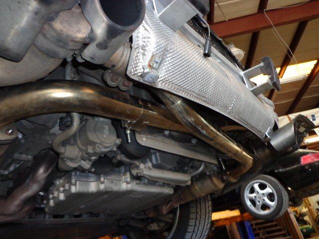

Here's the heavier stock side muffler vs the incoming lighter-weight Tubi:
The SharkWerks and Tubi exhaust installed together:
