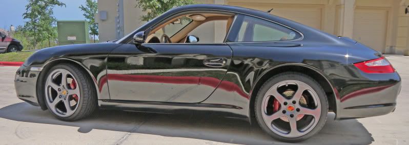

there's a fine line between slammin' it and lowering it, IMO.
i can understand those who want to keep it all stock because they believe Porsche knows best.
I can also understand those who want to mod their Pcar.
OP, as others already stated:
- US versions are slightly higher than European ROW specs, so i don't see anything mechanically wrong with lowering our cars a bit. Even the US Pcars with SPASM are lower than 'stock' for better CG and handling. Of-course, the proper way would be with coilovers but springs with minimal drop would be fine too, IMO.
- road condition near u really doesn't have anything to do with lowering it. Road condition is more about the size of the rims and the side profile of the tires. I.e. 20" rims will be harsher than 19" with similar sized tires.
- if u get an alignment after the spring settles, the tires will wear out more or less evenly. All Carreras i know has faster inner wear due to slight negative camber regardless if its lowered or not.
There was no way i was going to live with the 3" gap in the rear after i got the HRE rims. Just look at the pic (Pic 1)
I got the Eibach springs (supposedly same as the Techart springs without the high price) and very happy with it. I was afraid it would be bouncy, but the PASM is just as effective now as before.
But best of all, the car looks much better without the big gaps (pics 2 & 3) You can even enjoy tracking it (pic 4)
keep us posted OP
