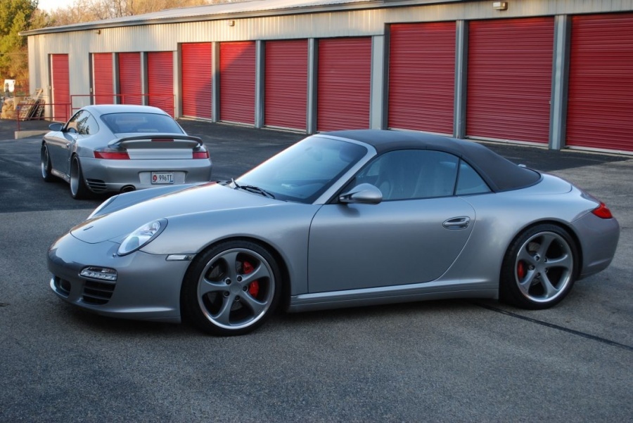

Driving 'low' is an aquired talent but I'll admit there's some places you just need to come in a different way.
Where am I?.....well funny you shoud ask SanFran.....I'm in the Berkley of the MidWest, Madison, WI.
This C4S (wife's) has Damptronic suspension adjusted around 20mm down from PASM (already supposedly 10mm down). I have other cars that are lower and yes occaisionally scrape but really, not often.
Right now the one below is outfitted with winter fitments and HT. I'll admit, once or twice a year ground clearance is an issue......snow.
