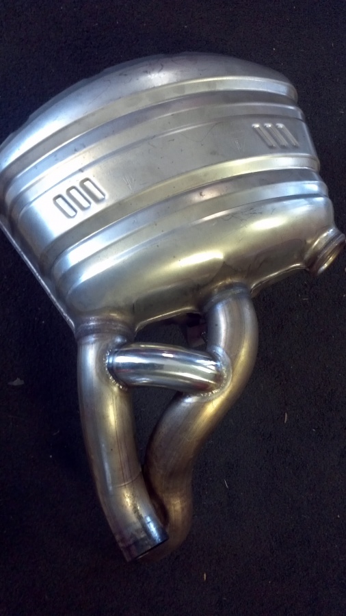

Had the Gundo hack done yesterday. Work preformed by Blue Grass Mufflers here in Louisville. I took pictures of Fister modified mufflers and asked Alex, the owner to do the same with my mufflers. It was his first time to mod P car mufflers. Fisnished product looked great. Very pleased with the workmanship. Sound great on the car. Louder under full throttle than I expected, but sweet sounding. No drone. I paid a little more than most have stated they paid, but I think it was worth every nickel spent.

nice mod!
i have done it 3 month ago and love it so much!
And your welding job is so clean!
But when I get used to this gundo sound, I feel like it is not that loud again.....

Very clean job and worth the extra money.

Keep in mind that the 'price' is just for the fabrication. All in, mine were right at $500 after factoring in tax, shipping to me, and shipping the cores back to Darin. There was a shop here locally that said they could do mine for $550, which included removal, fabrication, and re-installation, but I was not sure what the quality would be like. I am VERY happy with Darin's work. I figure I saved $50 because I did the removal and installation myself.

seems like alot of money, I took mine off myself and paid 200 for the weld..I was told guys paid even less. All in all it s worth the money for the mod. Much more enjoyable driving the car.

I ordered the stainless pipe myself and had it sent UPS to me, then I took mufflers off and just took them to a welder and explained with a pic. Just an idea.

double check me but I think I used 304 stainless... can be ordered online or picked upat a local supplier. Example.
http://www.atlanticstainless.com/pro...tube-fittings/
2 inch , maybe a 10 inch long piece should do both sides. Cost was about 50 bucks.... I ll try and locate the original thread.
