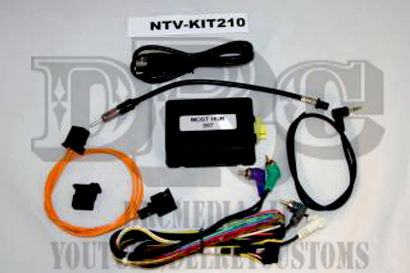

Got a package that does it all
Stage 3
Alpine INE-W927HD
Sirius
Ipod Cable
JL Audio XD600/6
Focal PolyGlass P165V33
Focal Polyglass PS 100
Wire Install Amp kit Stinger
Alpine HCE-C104 Camera
Porsche Silver Dash Install Kit
DRC Sub (2) 6W3V34
Upgrade Amp XD700/5 (instead of the XD600/6)
Total Shipped 4000.00 Inc Shipping

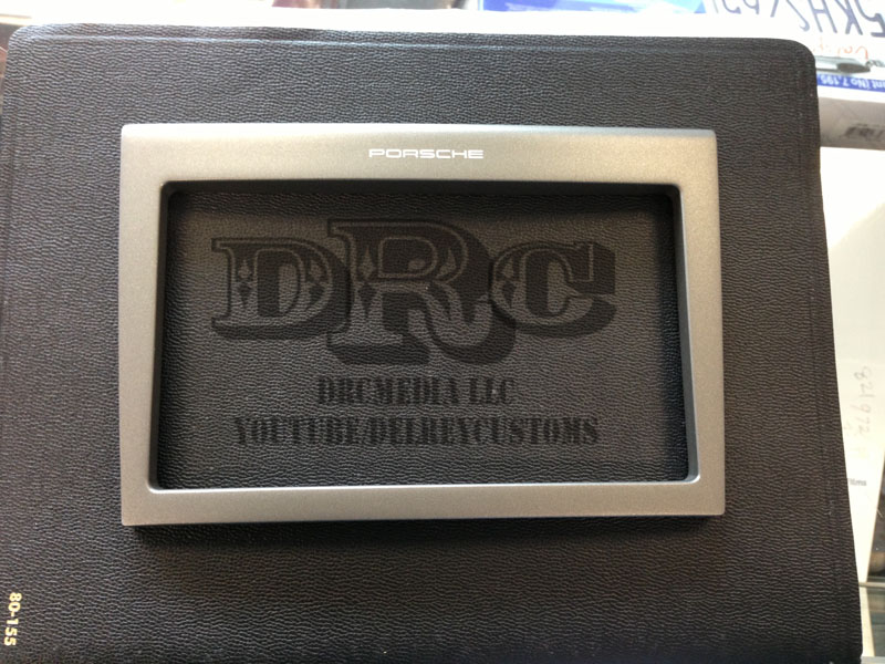

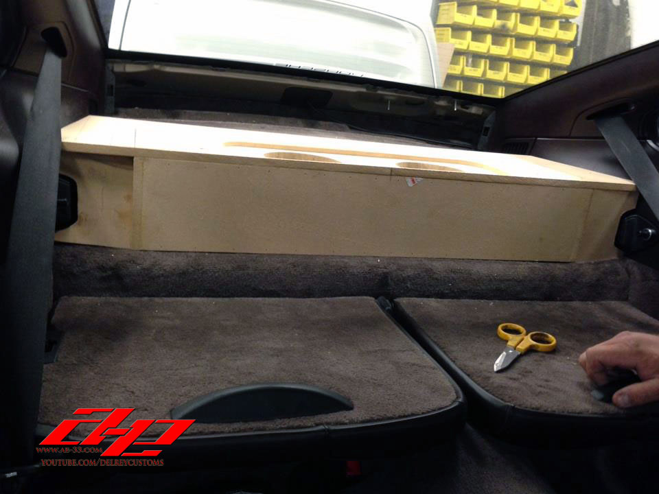

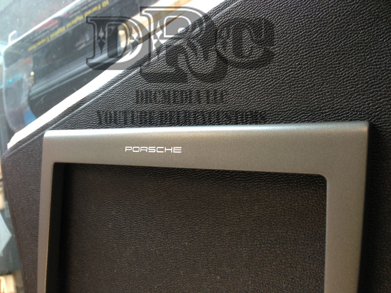

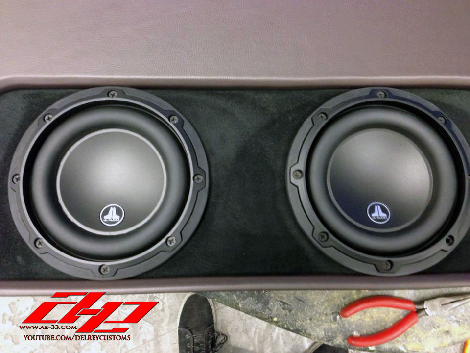

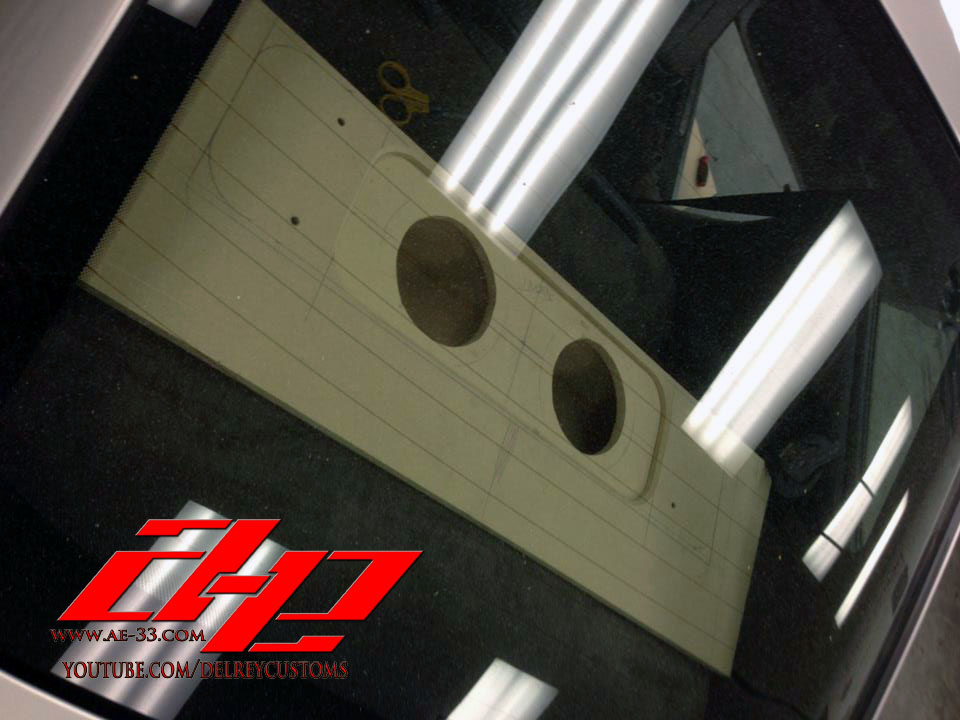

997-HUR parts with silver logo dash kit 2-din Porsche 997
Stage 3 Sub Box Upgrade with JL Audio 6W3V34

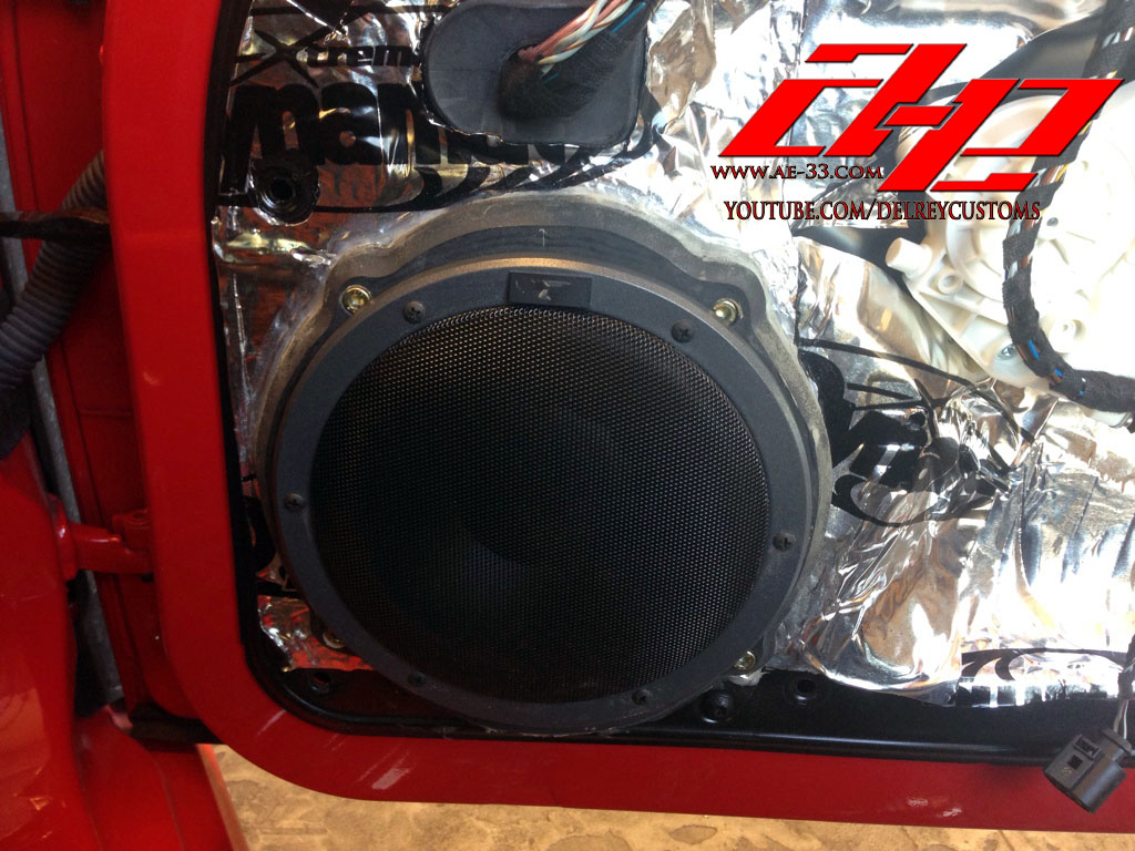

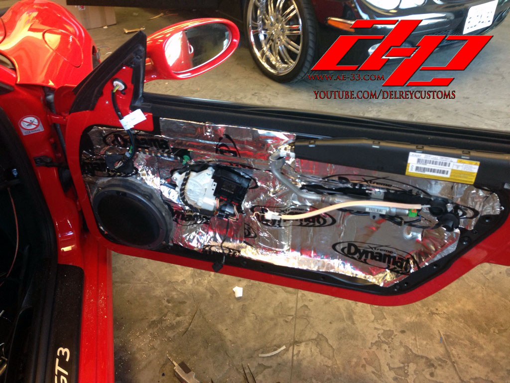

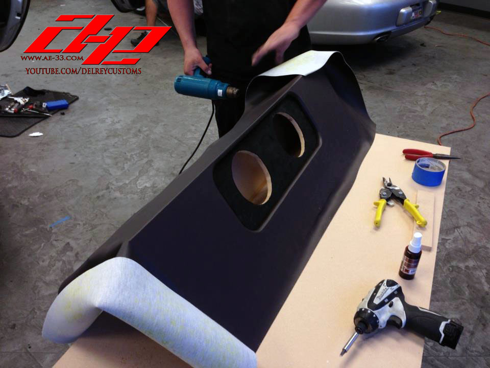

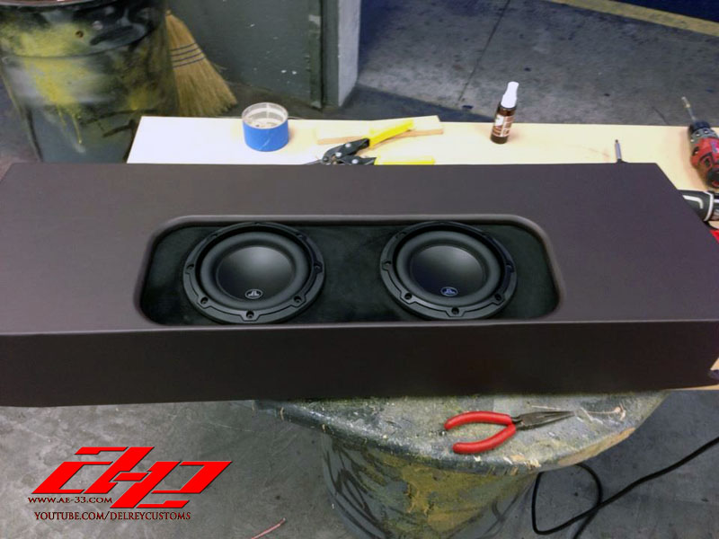

I'll be happy with anything other than what I have now. I don't expect to match or surpass a home system, I just want quality audio when driving. I like the sound of the car and the road, but that goes with music just like beer and football.
From my experience we use alot of the JL XD600/6 and XD700/5
some advice put the amp under the passenger seat.
use a good quality RCA, Stinger 8000 series are affordable and have the TDK style build in noise filters (fer-rite filters).
Use a good 4 awg power wire and there is always a chance for noise when dealing with a 911.
If your using crossovers with ths speakers make sure they are mounted high up on the fire wall or where the factory amp is
if you put the cross overs in the kick panel next to the fuse boxes be prepared for engine wind.
Other than that good luck if you need some parts or advice just email me we always try to help forum people an I do about 3-5 Porsche install a week.

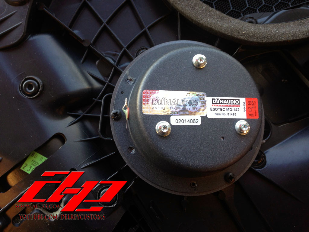

Originally Posted by DelReyCustoms
DYN Audio 8" 3way x362 compnets are a beast in the 911. thoes alone with a good 150x2 amp is all you need it you want to keep weight down and have killer sound.
Dynaudio is ok with me too. I notice all pics are from 997.1. Any pics for a 997.2 with bose?
