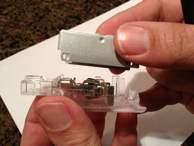

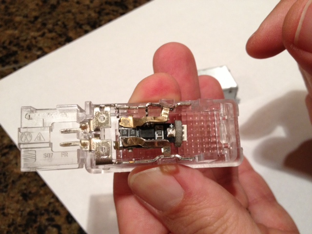

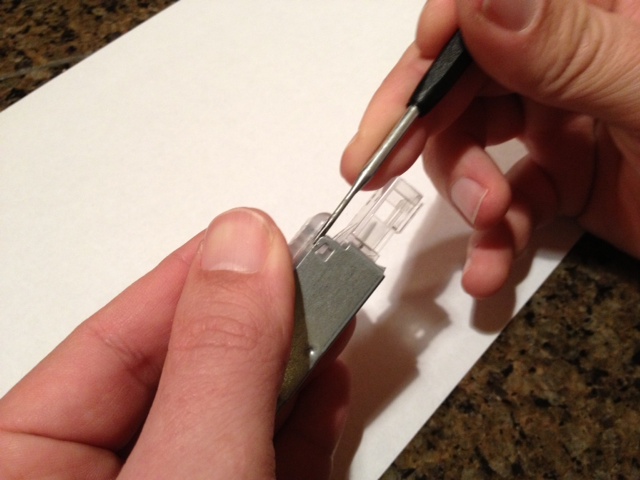

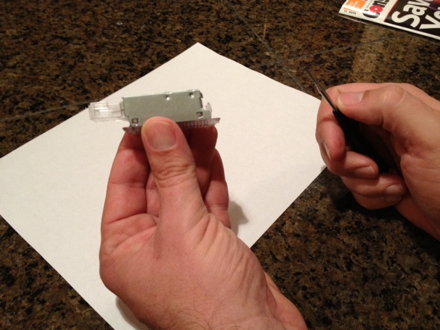

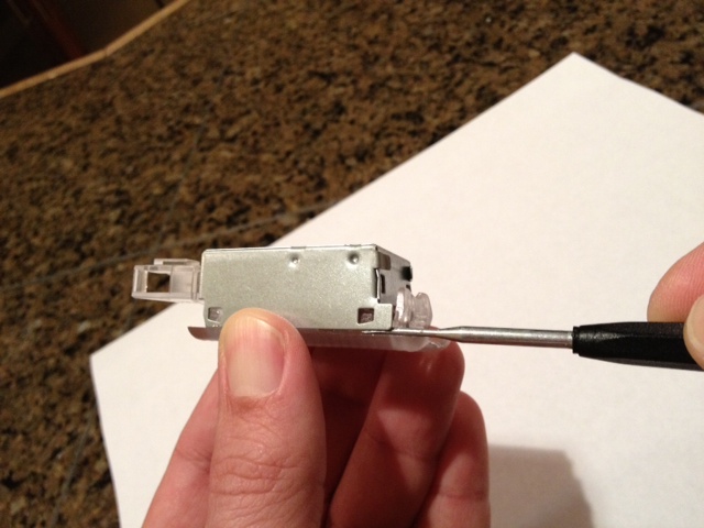

Use a small screwdriver, pry off the 2 edges on 1 side.
Then do the same on the other side.
Slip the cover off
Then replace the bulb with an LED bulb as shown
Hope this helps
