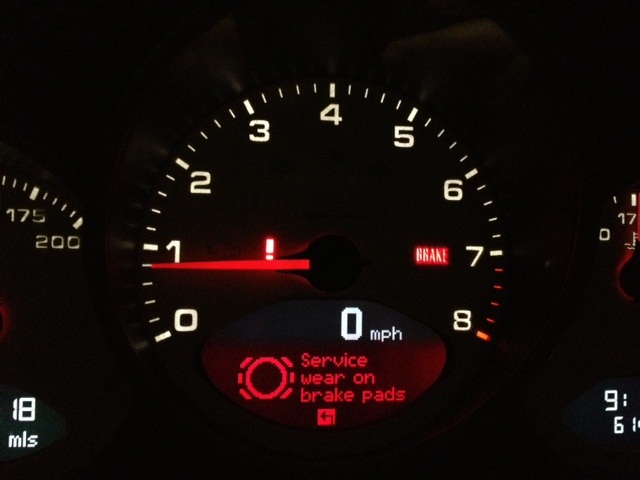

If the light is on, one of the sensors has worn through.

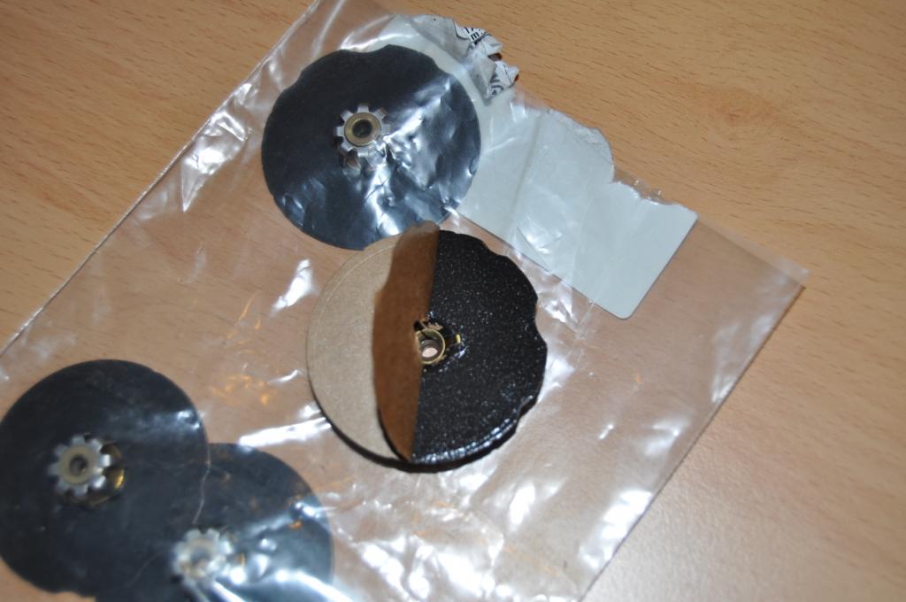

Are front brake pad dampeners reusable? So if the warning light is on for brakes, sensors must be replaced as well - anyone try aftermarket sensors? I believe this is the first time pads are changed (car has 30k miles)

I think by "dampeners" you are referring to what I call the anti-squeal shims. Those are reusable. You may be getting a warning light because the pad has warn down to the sensor. The sensor may or may not be shot. I'd order new ones just in case. It's also easy to break one when changing pads.

The anti squeel shims are adhesive so doubt if you'll be able to use them again. you could try double sided tape though.

Front pads and sensors ordered...just one other thing...is there no way to tell if the warning refers to the front or rear pads? I just assumed it was the front bc they looked more worn down so gonna start with those first...any insight...?

You can reuse the shims. I take them off and put them back on every time I change pads to go to the track.
The shims are not adhesive. Do not use double sided tape. The heat generated by the brakes will melt and burn it and likely make a mess. If there is any adhesive it is from an anti squeal spray that has been applied to the back of the pad. I often use the spray because I have it in my garage. Not sure if it helps at all. You do not need it to reinstall the shims.

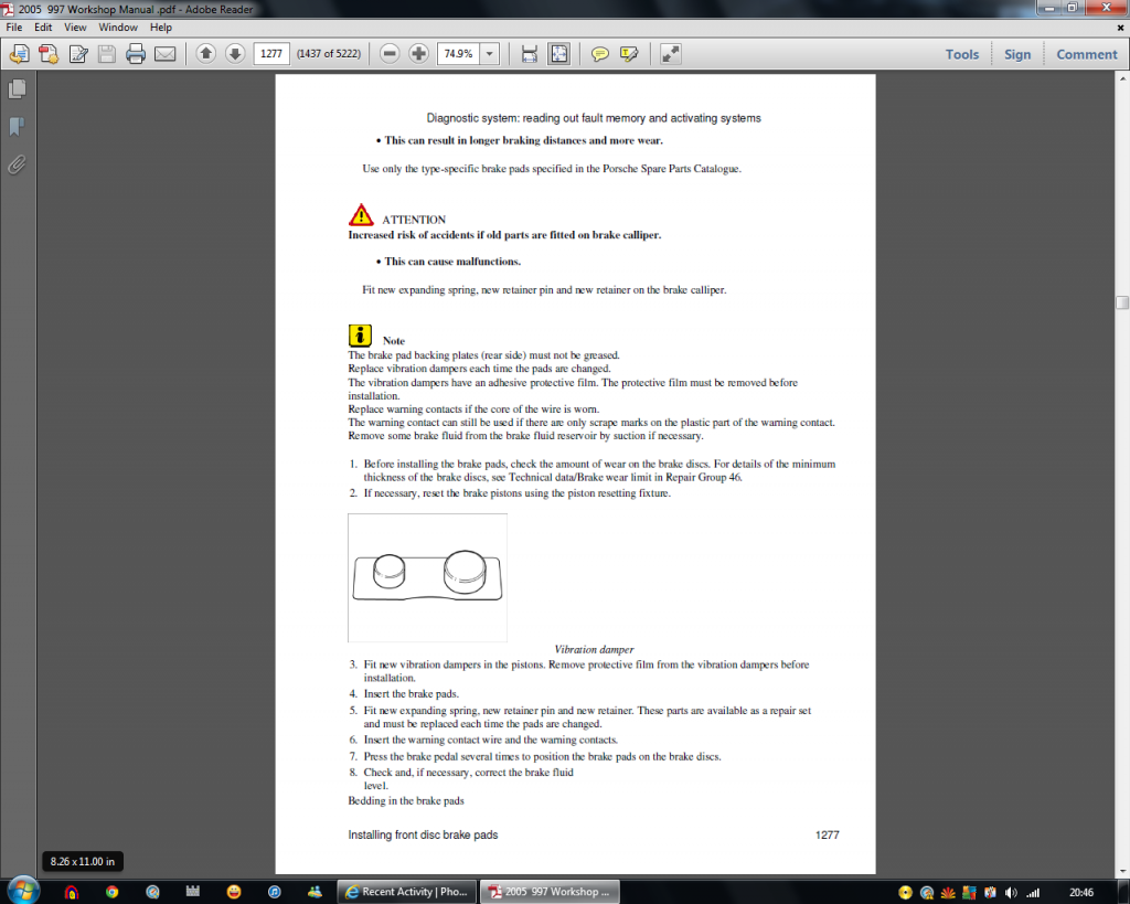

As I said, the dampers ARE adhesive!!
I have a full set of fronts and rears here as they are not meant to be re-used.
They are designed to stick to the pad and be supported in the piston to reduce braking resonance.

Here's an extract on pad replacement from the Porsche Workshop Manual:
