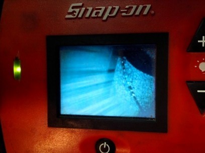

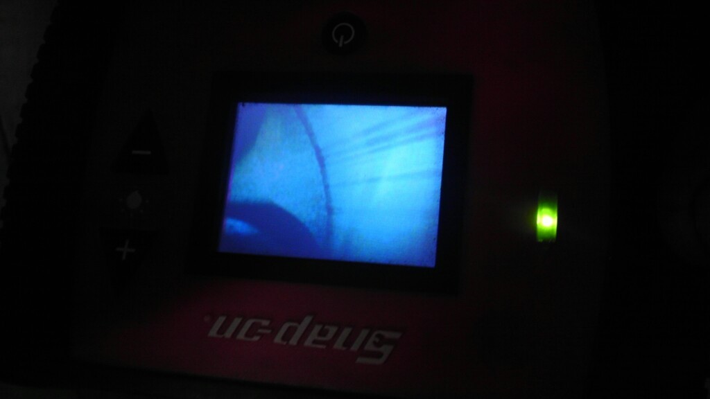

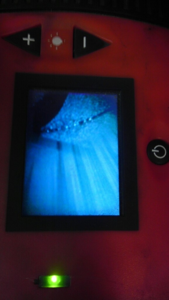

Finally got to see pics of the engine.

What are we looking at here?

You're looking at the piston's head and the cylinder wall, pic taken thru the spark plug hole.
What was your indy assessment? Are those normal scratch marks?
Is your car back on the road?

Sorry for the lack of information. Holden is right pictures were taken with camera inside the cylinder.
The opinion of the guy that did the pictures is that we should go for a new engine. Indy is arriving today to take a look at the pics.
The way I was told is that there is no way we should attempt to fix the engine.
I'm semi-retarded when it comes to mechanical stuff so I posted pics here both for your opinions while I'm waiting for indy) and future reference to those suffering from IMS failure.

I wonder what the leakdown numbers were, if the mechanic performed one.

In pics 1 and 2, did he say that those are metal flakes, ball bearings, or what? Sorry for the inquiries, but I am somewhat of a engine-rebuilder-geek and I am always curious about engine internals.

Honestly I didnt ask. I was so annoyed that I need to shop for a new engine that it didn't cross my mind. I'll stop by tomorrow and get all the information. I'll let you know.
It's not ball bearing since we found all the pieces when we took the IMS.

I agree with Cab83, a compression test could reveal a number of things such as worn rings, cracked engine block... In your case you need to inspect for any damages to the piston head and broken/bent valves. A failed IMS could cause the timing chain to skip and thus cause this type of damage. As I wrote in an early post, when you started the engine and it ran perfectly at idle tells me your timing chains did not skip a gear, therefore your valves were not damaged against the piston heads.
To be on a safe side, have your indy do a compression test and check the condition of pistons and valves.
