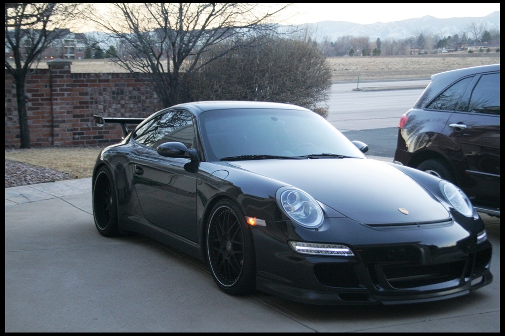

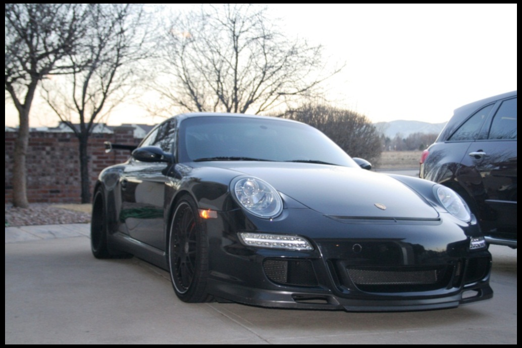

Update, I installed the resistors they came with the rear LED's and the error went away, drove around and the error never came back.
Here is a couple of quick shots I took, when I got home.
