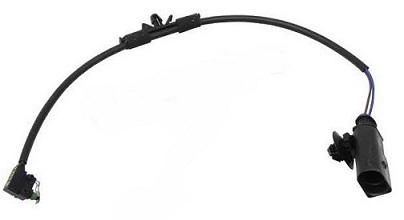

I just fought this battle last weekend. There are several switches involved- one to detect if the external door handle is raised (someone posted a picture of this in this thread), and one attached at the bottom of the door latch assembly to detect if the door is open.

If the window does not drop to break seal when you pull on the external door handle, the external door handle switch is stuck closed.
If the window drops to break seal when you pull on the door handle, but raises again when the door is open and you release the handle, then the latch switch is stuck closed.
In my case, it was the door latch- The window would re-raise while the door was open. I could lightly bang the door near the latch area to free that switch temporarily and the window would then drop. After replacing my latch, I saw a lot of gunk holding the microswitch down. Unfortunately, the microswitch cannot be easily cleaned without loosening or removing the latch assy.
There are other evidence of states such as door\interior light states, ability to lock the car, etc. that you can use for troubleshooting. i.e. if the door latch microswitch is stuck open (i.e. thinks the door is open), then you will get an error when you try to lock the car, or the window seal does not engage when you shut the door.
