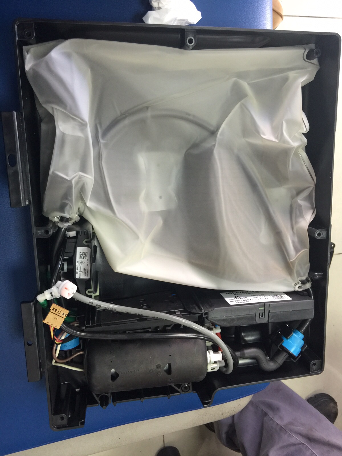

How to fix Porsche turbo 991 spoiler failure ( adjust speed ) error

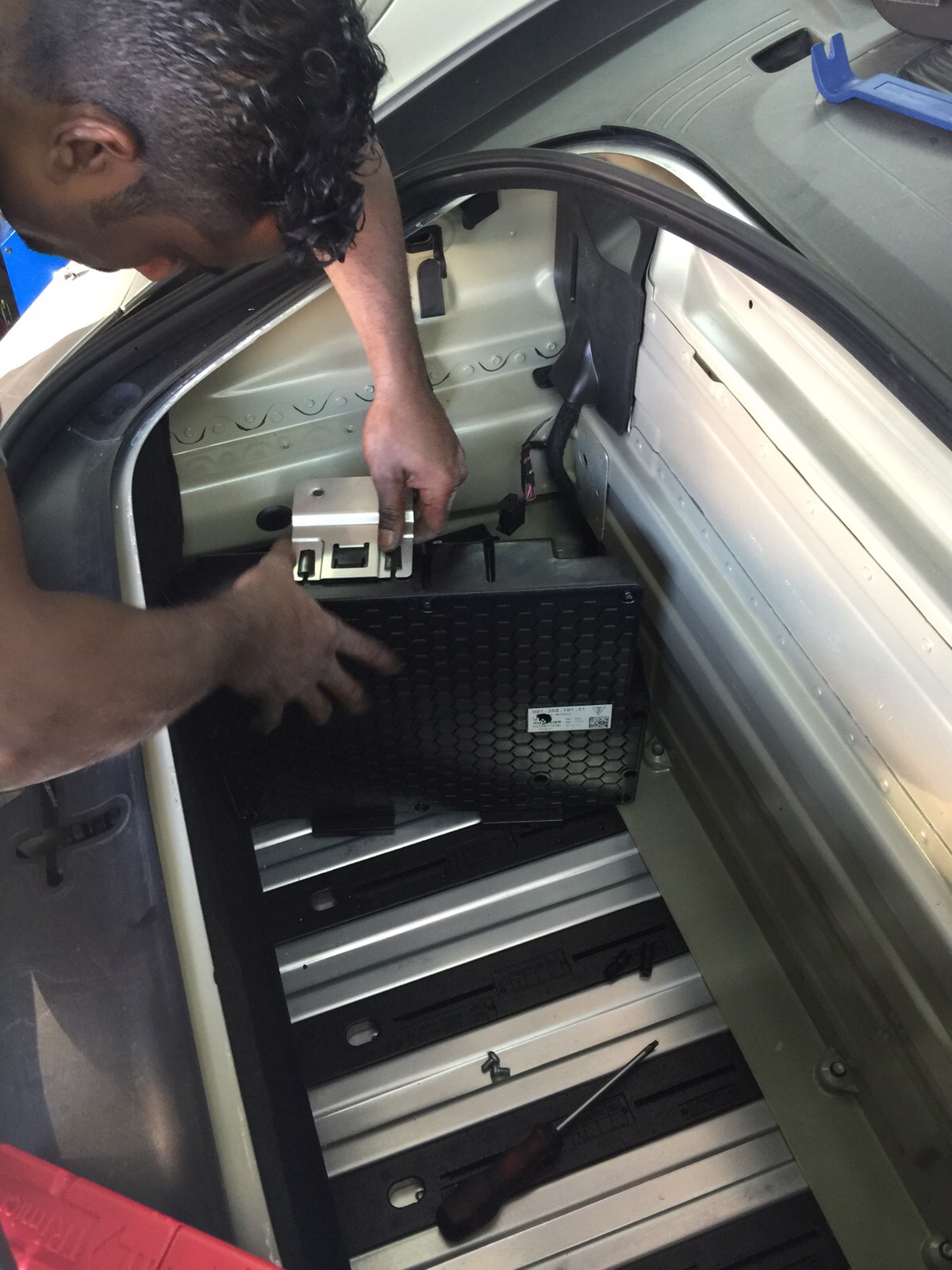

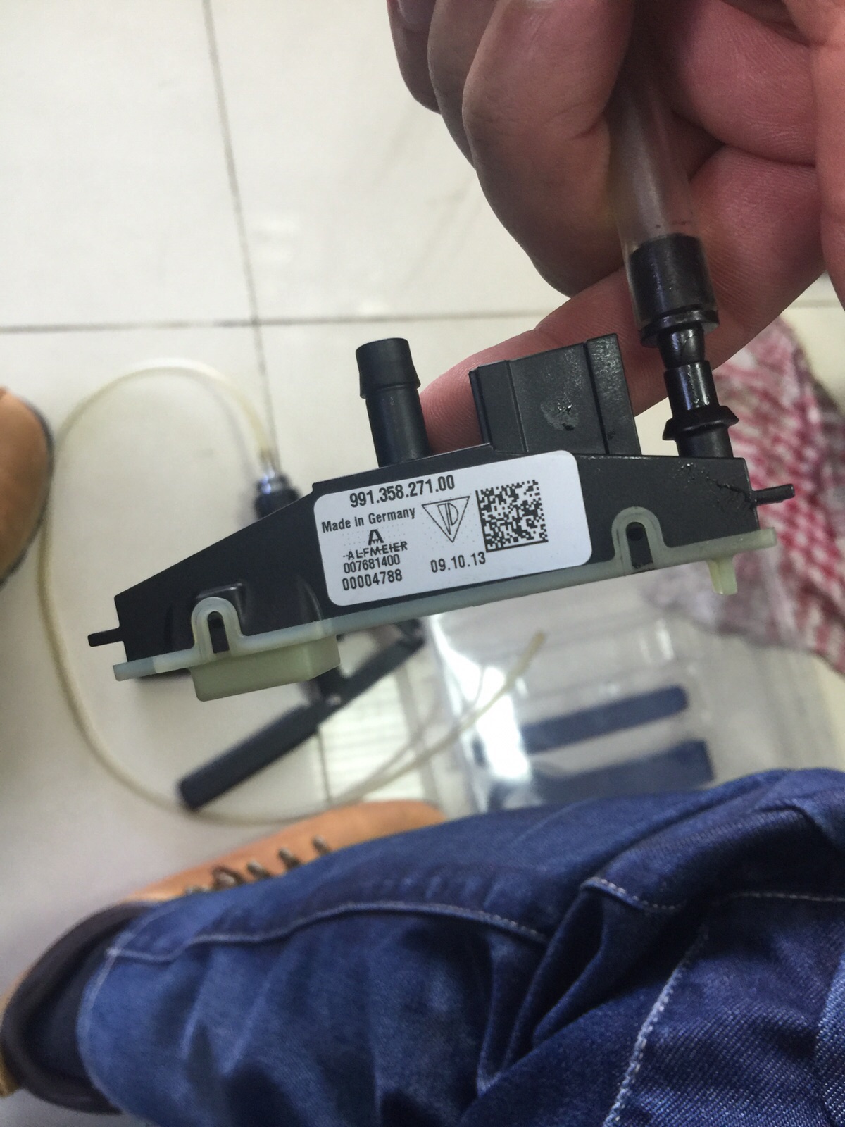

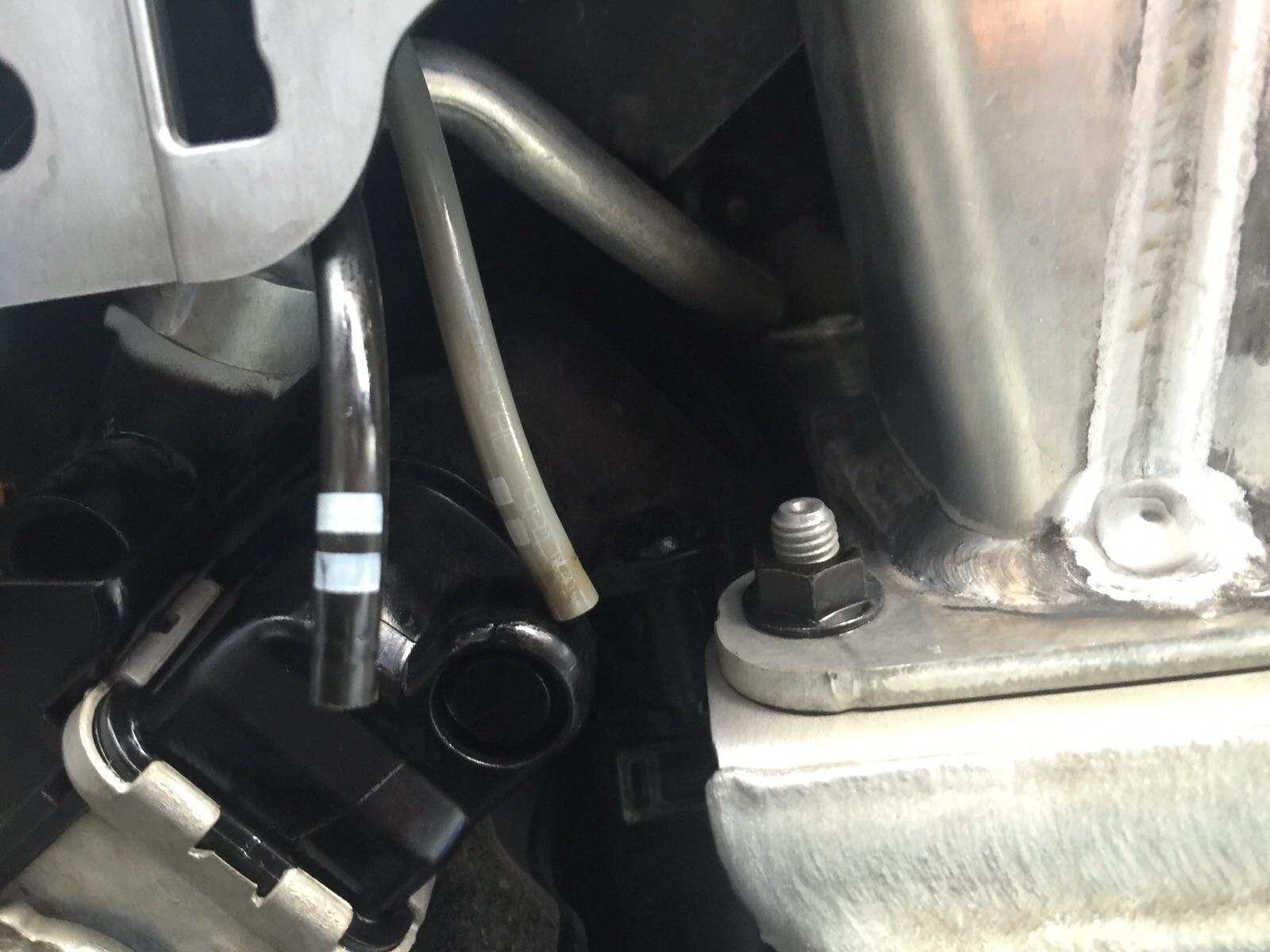

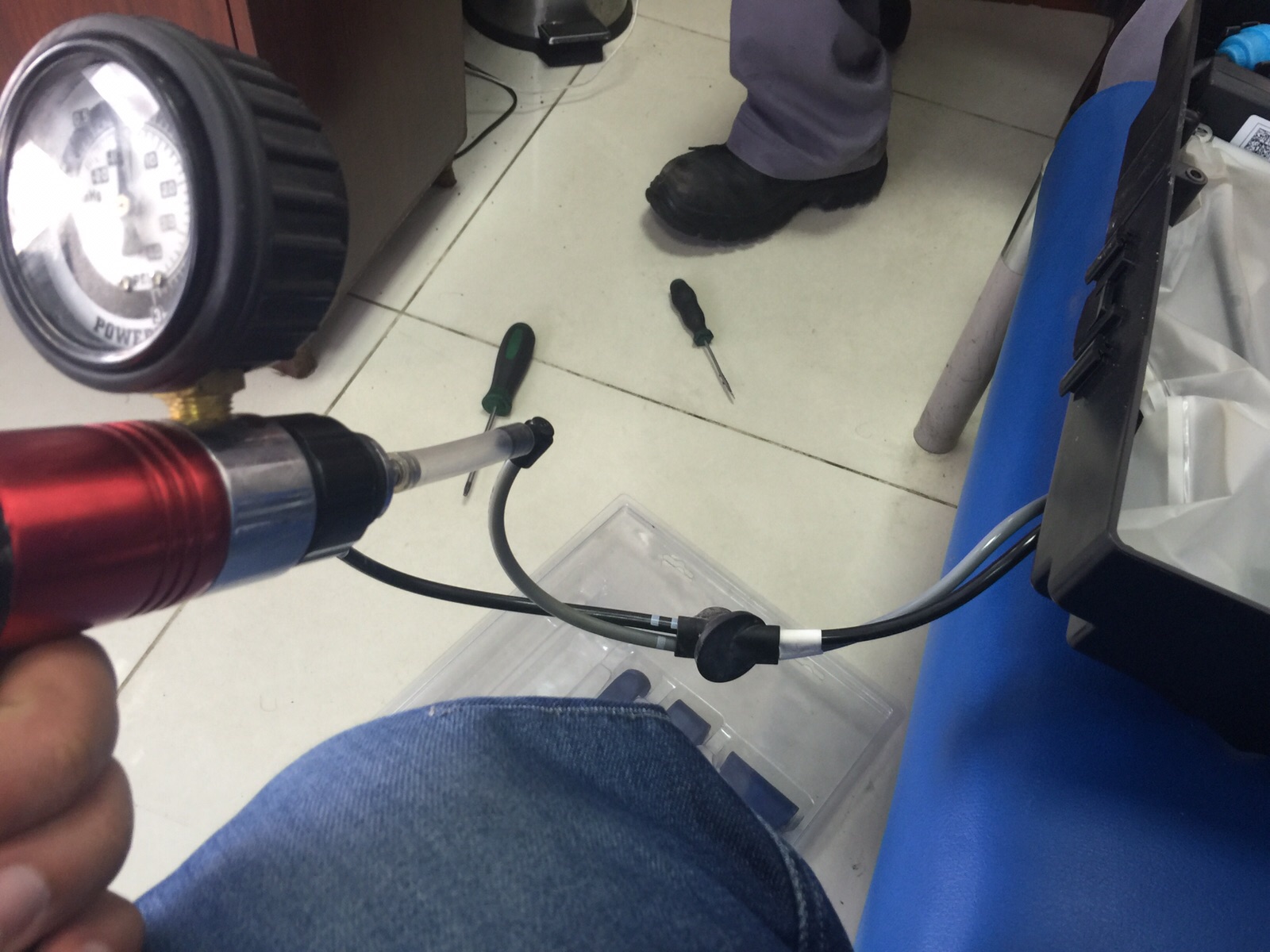

First of all , this problem is from air leak in front spoiler system, sometimes it is not , if you found front spoiler message on fault memory then do the following steps,
This thing is all about 30 minutes to fix and be happy.
1-under the front bumper there is two hoses ( black and grey ) black for long tube and grey for short one in corners those tubes when filled of air the spoiler will open and when air released it will close , using pressure tools try to connect each pipe one by one and fill with pressure to reach 1 bar , if there was drop in pressure then change the front spoiler or try to fix it if you found the leak point
2-if there was not leak then use the same hoses but backwards ( the two hoses connected to the air pump , one by one )
, same pressure 1 bar , if pressure dropped then you should open the black box under the hood ( under the carpet right driver side )
Disconnect and open it.
3-find the electronic check valve ( test again and you will find a leak there, this part is cheap but porsche does not sell it as a single part , you should buy all air bump system ( black box )
Arround 1000 $
4-you can re-seal this part and use it again.
5-reset fault memory and feel happy.

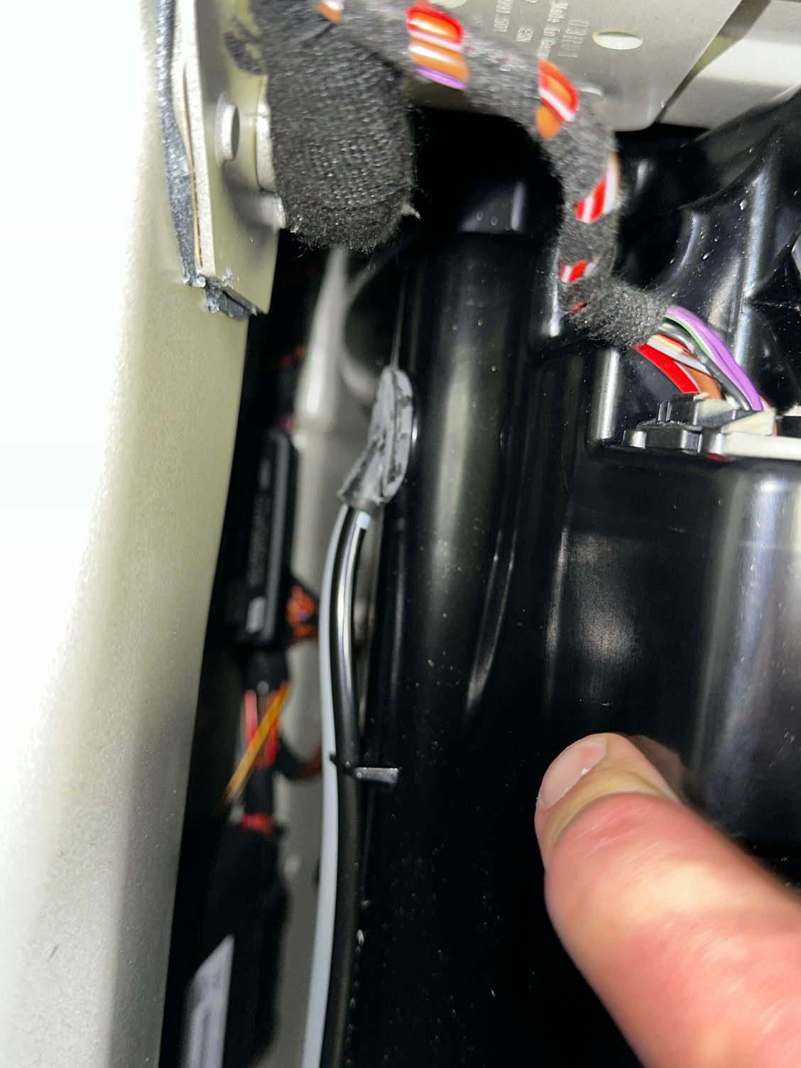

Do you mind sharing how you get access to the electrical cable and where it is?
My spoiler light keeps coming on at 78mph, but works fine when manually deployed…I have cleared the codes several times.
I have a ‘15 991.1 Turbo S

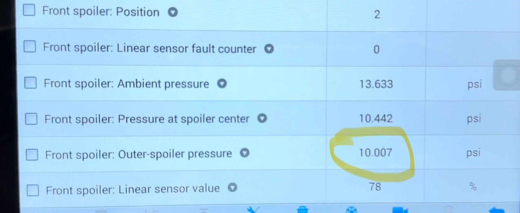

Adding to this thread as I have been searching across the interwebs trying to solve my spoiler problems.
I am gaining ground, but still in need of help. As stated previously, my spoilers work manually but once I hit 78mph, I get an error and the spoilers retract.
Tonight I discovered that the “outer spoiler” in the front is losing pressure. When I activate the front spoiler, I initially show around 10 psi for “outer spoiler pressure.”
I let the car sit and monitored the data….the psi of the outer spoiler kept dropping…
After about 5 minutes I was down to just 3psi, well the other pressures held steady.
Now I am trying to determine if the air is leaking at the spoiler, the hose, or the black box.
