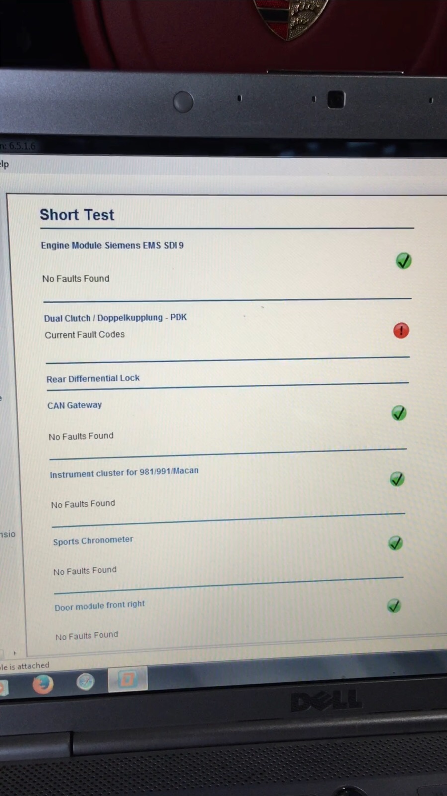

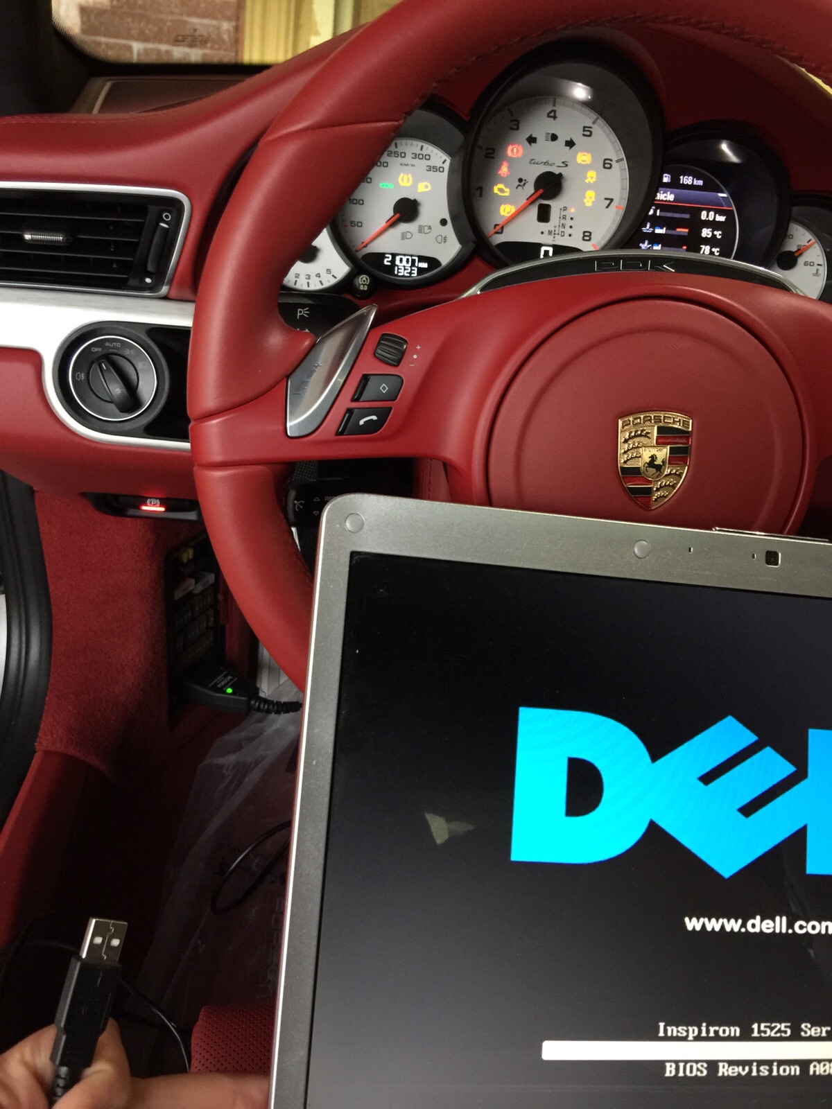

hello guys , i have the 991 turbo s 2014 and i always keep both spoilers open , even in sport mode or sport plus , i never close them.
suddenley when i was accelerating above 130 km/w , ( spoiler loss message came ) and both spoilers closed at the same time , i do not know why , also the spoiler button was not blinking and even not working.
i did reset to the fault memory , it was showing fault only ( nothing actual )
then the spoiler worked as well again , i tested by opening and closing many times , everything was fine , accelerating again above 160 km/h , it was working,,
that was yesterday , now the spoilers not working again due to acceleration above 130 km/h ,,
can you please help me guys solving this problem?
there is many posts about software update , some guys mentioned that dealer changed complete system on their cars.
but my system was working after reset ( thats why i am asking )
****** update ( problem solved by Porsche specialist ) it needed codeing , calibration by PIWIS system and also software update , front spoiler changed and the car became perfect.
