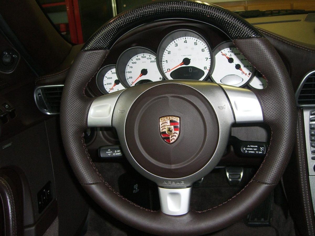

Originally Posted by dbcperformance
Looking into this, but I will DD the 997 so not totally sold on the alcantara. I know myself, too lazy to put gloves on each time I get in. Any thoughts on that?
If you wan't an OEM leather wheel, my favorite would be the 997 GTS wheel also used in the 991.
Aftermarket options exist as well.
To the OP, I had a very tough time getting my original 997.1 wheel's airbag to release. Tried several times over and over, I was about to give up and take the car to the dealer. Finally gave it enough force and it popped out.
I also devised a marking system using a tape template and marsh pen, marking the tape and spline. Since my new DCT wheel was also a 997.1 sport wheel, I moved the tape template to the new wheel, lined it up with the spline marking and the new wheel was spot on dead center from the first try.
Here's my DCT wheel.
