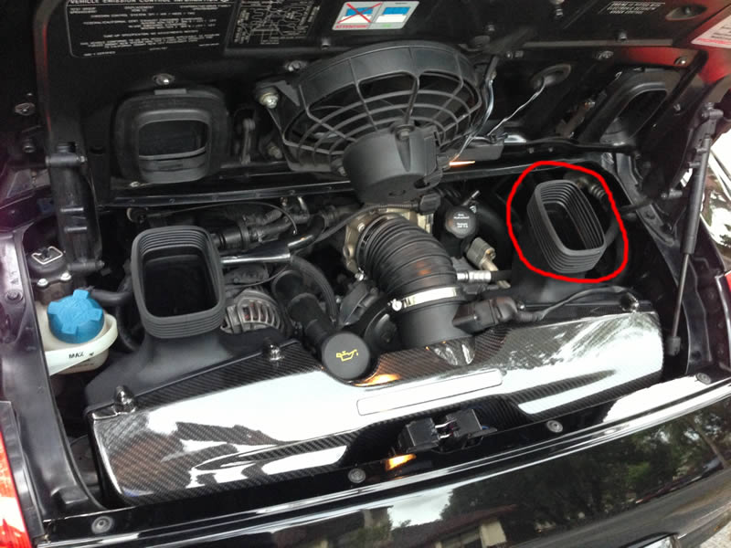

Hi there
Got an X51 airbox as you guys know, but its missing a part which Porsche can't locate for me as they need a partcode, I've circled the image in the part:-
Can someone please pull this part of their airbox, it just easily pulls off and should have a partcode stamped on it. Can someone post the partcodes which are stamped on it please to help me source a part.
If Porsche don't have it separately then I need to try and get something made up, otherwise my engine will suck in warm air.

Hi!
That part is not on the PET catalog. I pull mine off and this is what i found:
it's not a 997.XXX.XXX.XX part...

I just bought the part from the my local dealer and the X-51 side bellows is # sc997-110-252-00. The bellows for non x-51 or the left side (looking at the engine) is # sc997-110-250-00. Price should be $13.78. The non x-51 is twice as much.

I think you are getting confused with the rubber part that attaches to the deck lid. The OP is looking for the part that the deck lid mates to on the airbox. I have an x51 box I haven't gotten around to installing yet and I will look also after work.

I was, my bad.
Do you mean 997 110 250 00 is the rubber bellow I need which goes on right side of X51 air box?
997 110 252 00 is the duct which attaches to the decklid.
That correct and the parts I need?

997 110 252 00 is the bellows that attaches to the decklid on the passenger side. 997 110 250 00 is the bellows that attaches to the decklid on the driver side. I attached the schematic for the stock airbox above, but don't see that the lower bellows (that attaches directly to the airbox) is in fact a seperate part.

I double checked my x51 box. No other markings than what joelpirella posted.
