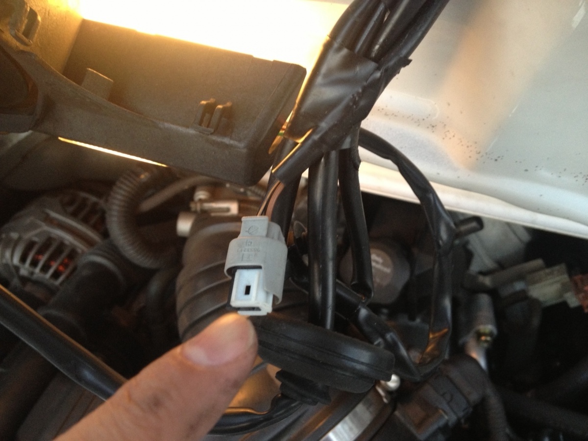

Hi guys, I have a Vorstiner fixed wing on my car and regarding to this forum I needed a "cable loom" and a reprogram to disable my stock 911 rear engine hatch.
I got the cable loom and got my car reprogrammed but I am getting a 3rd brake light fault code.
anyone have any ideas?
the dealer said it may be a wire not connected and wanted to charge me $280 to fixed and I declined.
thanks in advance.

heres apic of a connector not plugged in. where does it go?

When I installed my fixed wing I went to the next auto parts store and bought one of these load resistors that you use when you install LED brake lights. and connected it to the two wires in the connector in your picture.
Remove the plastic around the wires til you can see the two ndividual wires and connect the resistor between them
$15 fix

Thank you for the input. Does that fix allow you to use your factory third brake light?
