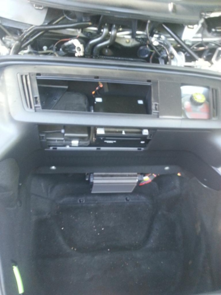

So far today I got pretty far. I removed the stock bose amp, the dvd navigation, the pcm, and found the portals to wire from the frunk to the battery compartment and into the cabin. I installed the gps antenna where the center speaker used to be so it's hidden and an unobstructed sky view. I also put the sirius antenna there but the instructions said to keep it away from the gps antenna which I did the opposite. I don't use sirius much so I'm not too worried about it, but if the gps is affected I'll move the sirius somewhere else or remove it. It was only $20 anyway. I got the double bin bracket installed and did a dry slide in just to see how it fits, it looks good! I put the bezel over the front temporarily and it looks good too, but it doesn't fit perfectly around the double din, but neither does the bezel that came with the double din. Odd. Maybe it will fit better when I really push everything completely in.
I took lots of pictures as I went along, but will post them next week when I'm done.
So tomorrow is a big day, amps, processor, wiring, hopefully speakers in the door, and the subs.
