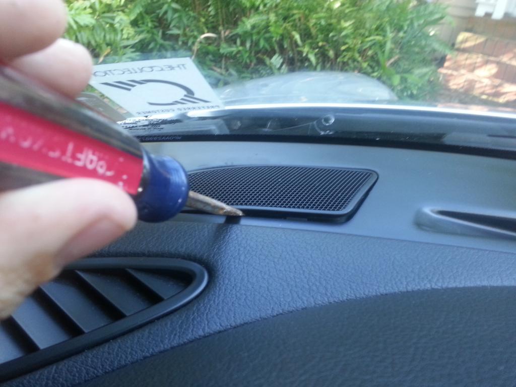

easy to pop out, carefully
[IMG][/IMG]

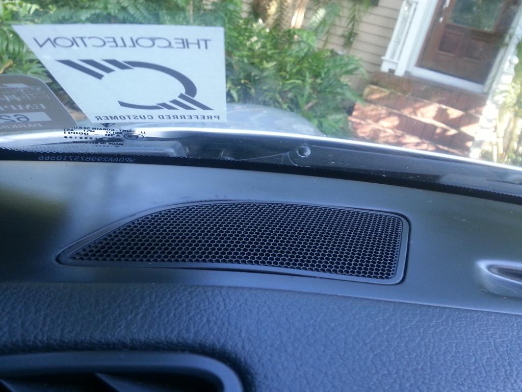

stock tweeters clipped in
[IMG][/IMG]

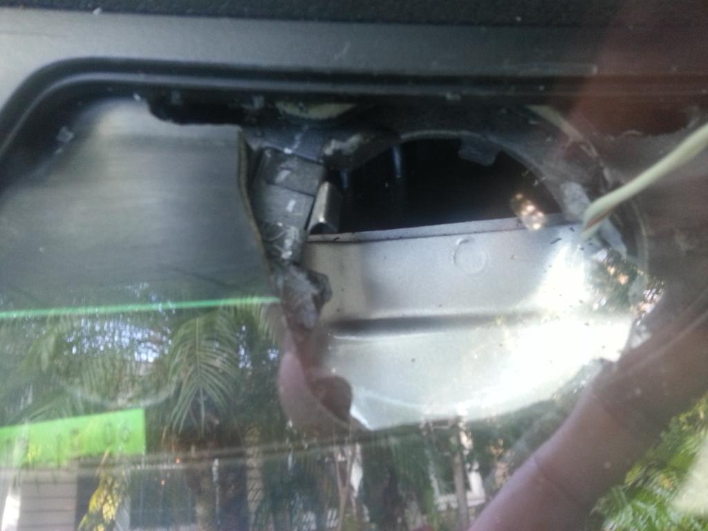

unclip and pull tweeter out[IMG][/IMG]

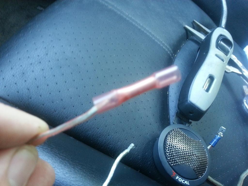

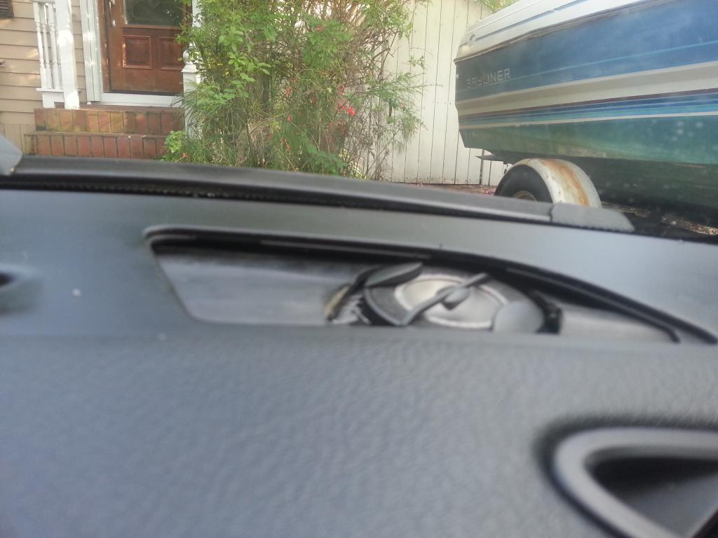

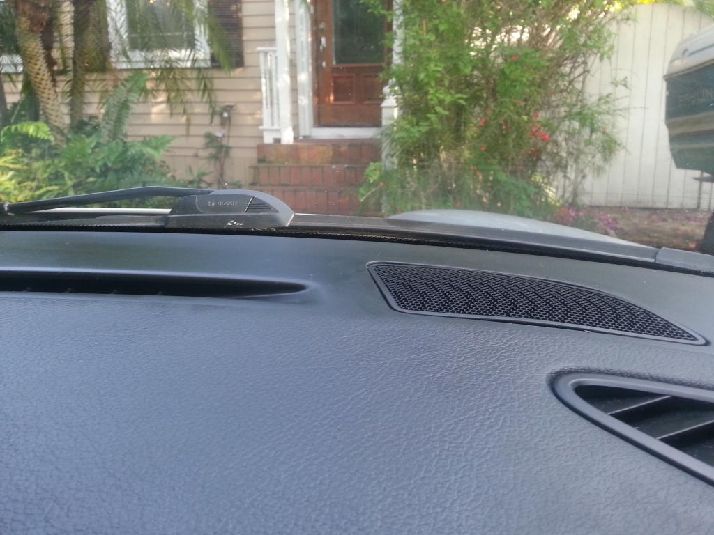

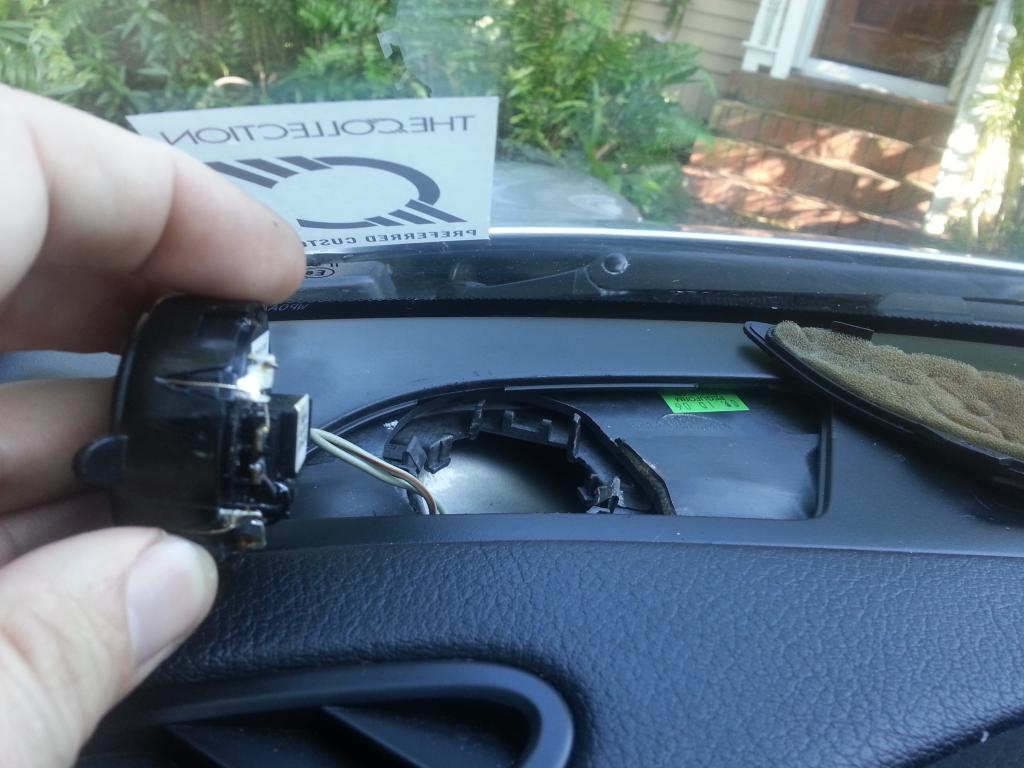

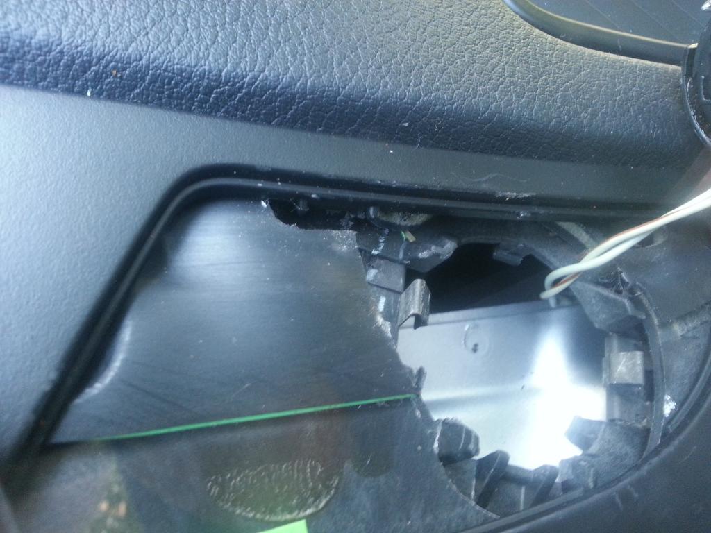

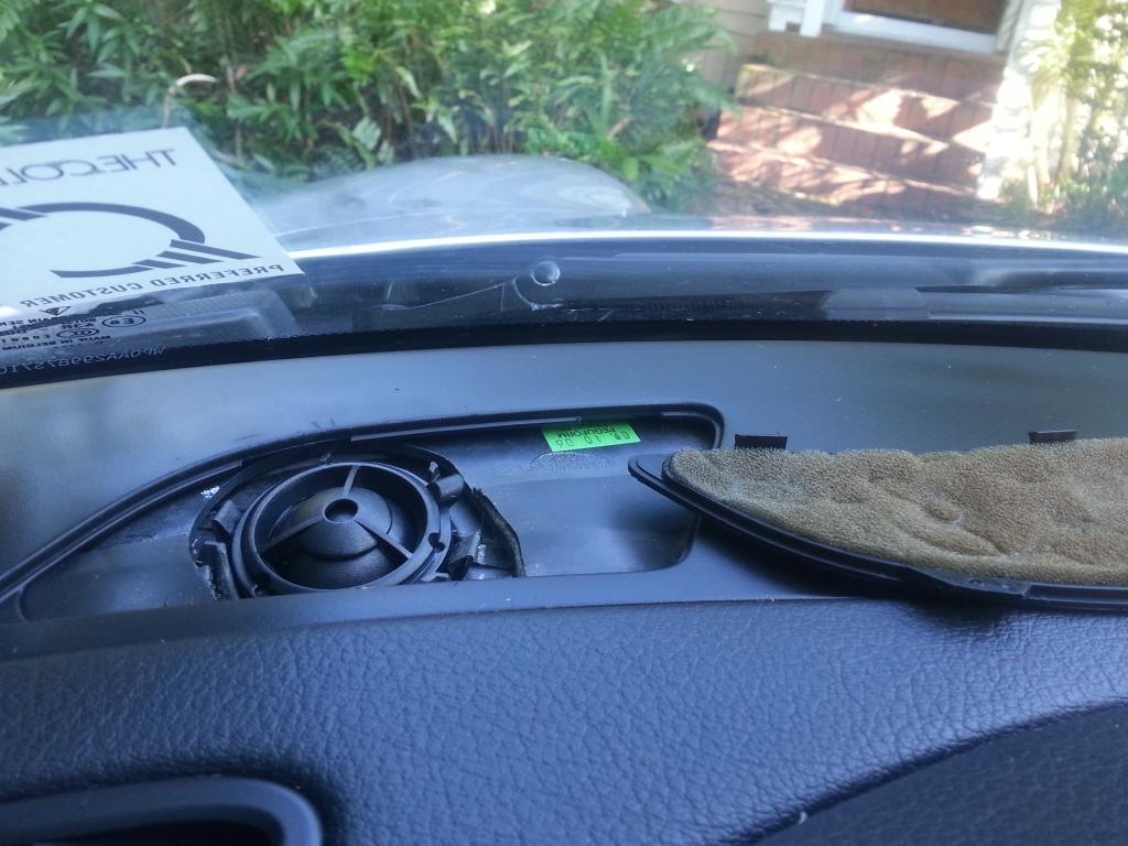

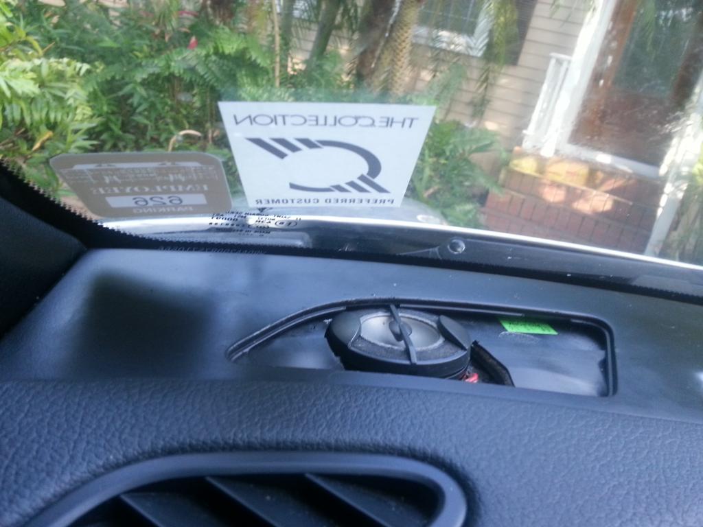

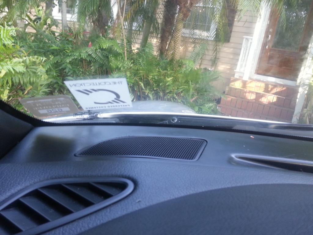

There's no going back now! I had to clip off the clips and plastic to make room for the larger tweeter. I did this slowly to get just enough room for the new tweeter. They both fit nice and tight, and flush with the dash. I just clipped the stock wires, rewired and heatshrink wrapped the connection. [IMG][/IMG]

It did involve some permanent trimming, but it's hidden, for the most part reversible, fairly easy (about 1/2 hour) and looks stock. I used needle nosed pliers to clip away at the plastic, which snapped off really really easily.
