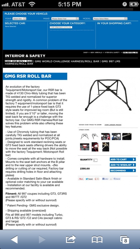

sorry, i assumed OP was talking about the "GMG RSR roll bar". the other one they sell, they (sort of) refer to as a harness bar ("GMG World Challenge Harness/Roll bar"). it doesnt connect to shock mounts. with that bar, you will have little to no stiffening of the chassis and somewhat less protection in a severe roll over.

carrera997re has a brilliant futurecarrera997re has a brilliant futurecarrera997re has a brilliant futurecarrera997re has a brilliant futurecarrera997re has a brilliant futurecarrera997re has a brilliant futurecarrera997re has a brilliant futurecarrera997re has a brilliant futurecarrera997re has a brilliant futurecarrera997re has a brilliant futurecarrera997re has a brilliant future
Thats the bar
Its the gmg rsr bar. I believe there is no welding involved factory bolts of the chasie

Yeah the rsr bolts to the front seatbelt mounts and rear strut tops .
The wc and lm bolt to the rear seatbelt mounts .
