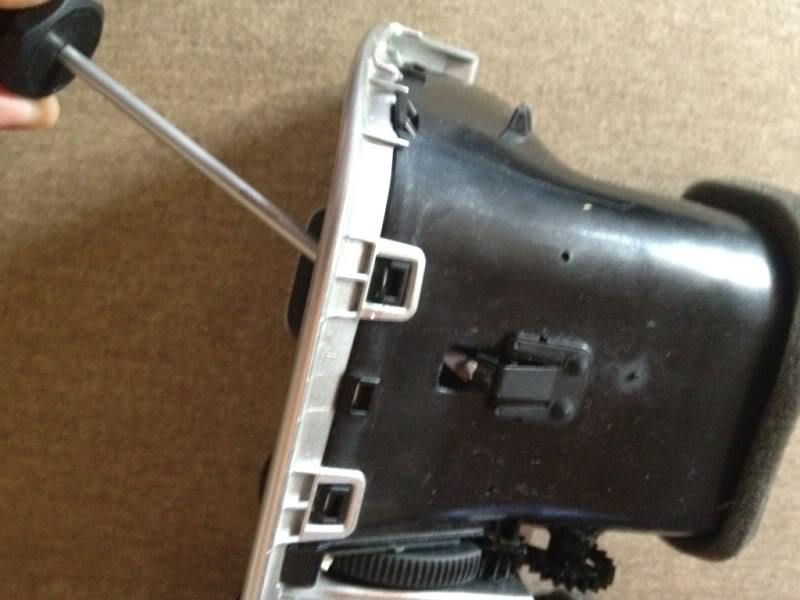

not the easiest to get out. i replaced mine a couple years ago. if your air fins are detached and you have all the parts, it can be carefully rebuilt, but if its cracked or missing parts be aware new ones are VERY expensive. > $350.
to remove you insert a pick or hook (a strong one) from the front into a clip on the top and center. the clip has a hole in it to grab but its still hard to do...pull out while pulling downward on the clip. there is also a wire for illumination that you have to be careful of.
just feel blessed its not the center one, which has two clips, and is an order of magnitude harder to remove
