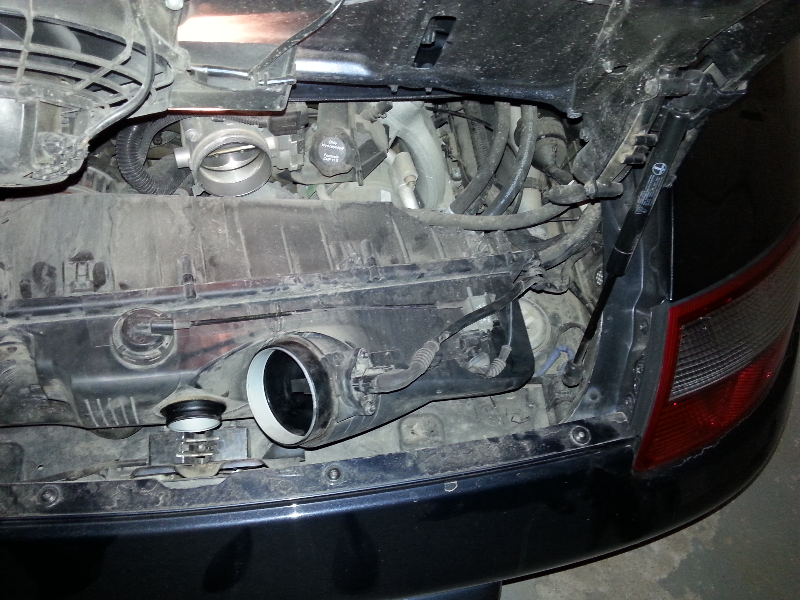

I recently purchased a fabspeed cai. tonight while attempting to install I bumped into an unknown situation. upon lifting the airbox I identified the air flow sensor as well as what appears to be a link cable and also some vaccuum lines. not sure what to do. I took a pic. ... its not the best but you can see what I'm talking about. does anyone know what I do lol?
car is a 2007 Porsche 911 c4s
thanks

I cut the vacuum line and stuck a screw in it

OP
I have same car with same CAI. I will look for my end result pics and you can see what to do. Did you get the carbon CAI or just that orange hose?

RaidersR1 is a glorious beacon of lightRaidersR1 is a glorious beacon of lightRaidersR1 is a glorious beacon of lightRaidersR1 is a glorious beacon of lightRaidersR1 is a glorious beacon of lightRaidersR1 is a glorious beacon of light
Take a look at this one....is this what you have ?
