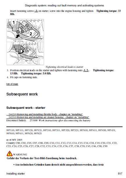

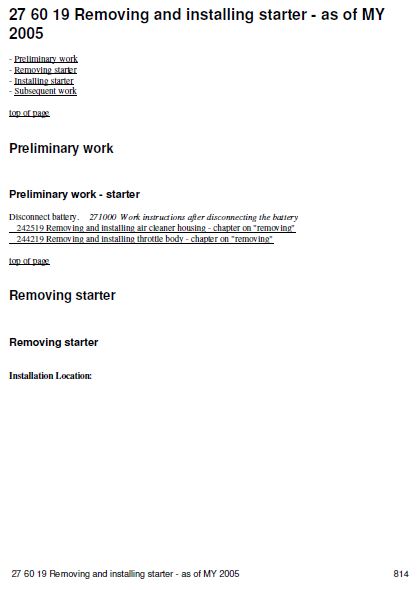

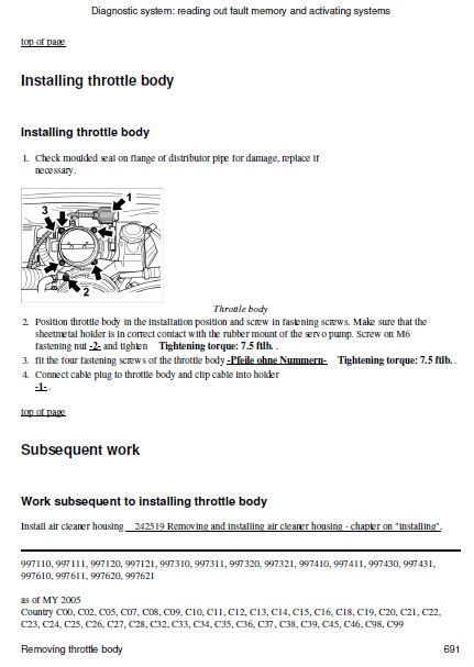

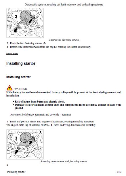

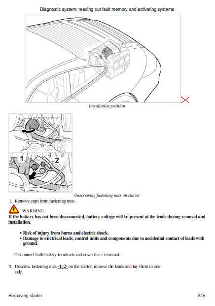

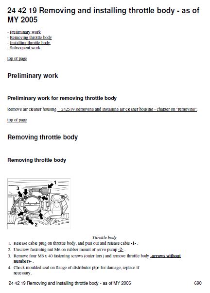

No need a lift. The starter is on top of the engine. Take note that you have to remove the throttle body first. GT3 may vary but you'll get the idea of the work involved.
Here is a link to a good DIY: https://www.6speedonline.com/forums/...ml#post3427155
Attached pages from manual:

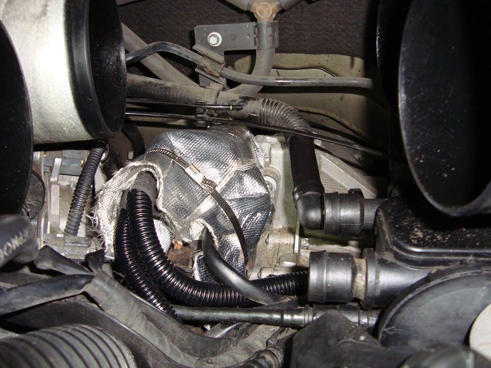

Good to know. I was in the engine bay tonight looking things over and checking all my grounds. I have good continuity but I went ahead and disconnected all the leads again and cleaned them up with a wire brush anyway. I thought that since the issue seems to be a problem with heat-soak, I'd try some heat shield wrap before I go and replace the starter. I'll post back tomorrow and let you know if it seems to make a difference.

Well...I don't think that heat shield made any remarkable difference. I tested it twice today after driving to and from work, which is about a 35 minute drive each way so the engine temps were all in the normal range. After I parked I would wait a few minutes and then restart it. Still sluggish trying to turn over. Oh well...I gave it my best. I guess sluggish hot starts are just the "charm" of a 997. I'll replace that starter later...like much later. I'm tired of tearing apart the top of that engine for now.
