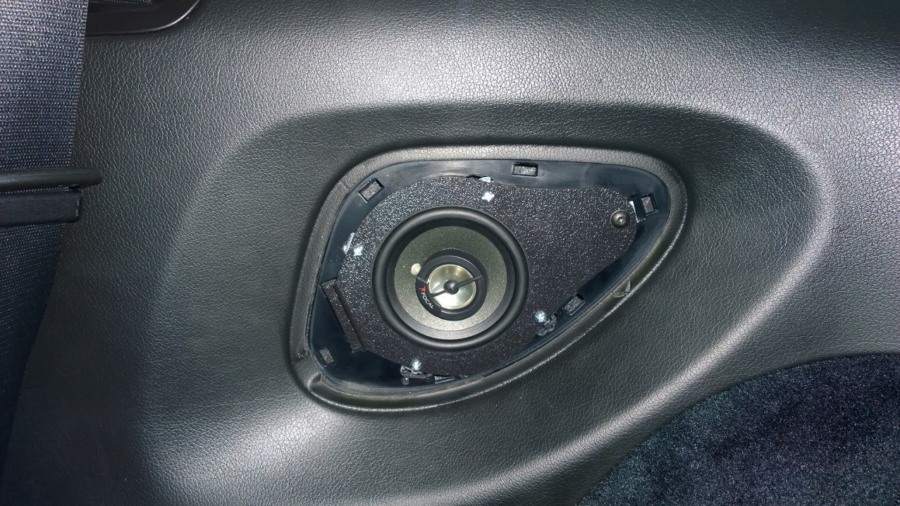

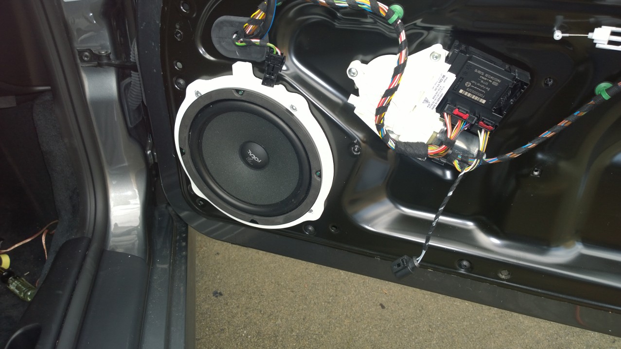

Ok, I am not done yet, but about 1/2 way there! I got some brackets made by my local audio shop. The front woofers hooked right up, I even reused the OEM connections, so no cutting or re-wiring! For the other door location and the rear, I took the advice of my installer and stripped the wire partially and soldered a connection to the new speaker, so there too, I could return to stock easily.
Have to complete things before I make any detailed feedback, but I am shocked at how louder (more efficient?) the Bose speakers are. Interesting. Of course, as someone who cares about the sound and not the loudness, I know this doesn't mean anything in an of itself. Can't wait to get it all together (plan is tomorrow after church) to finally hear it.
Thanks all for the tips/tricks! I followed this thread with no issues! The tip about the OEM wiring and the woofer is my only "find" so far. Wish the others were like that.
