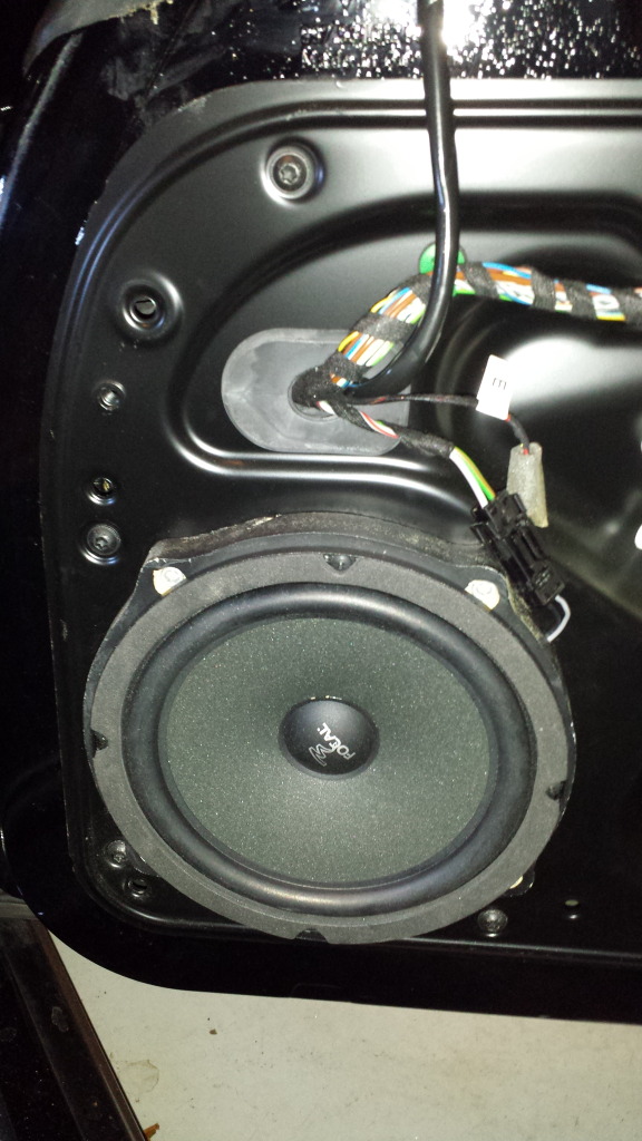

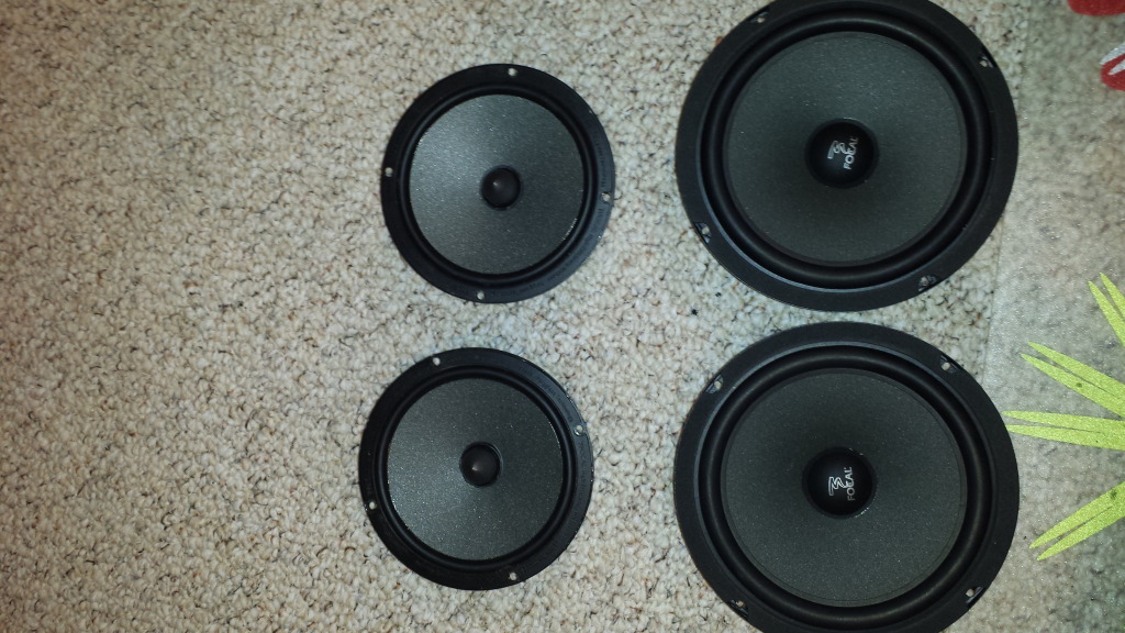

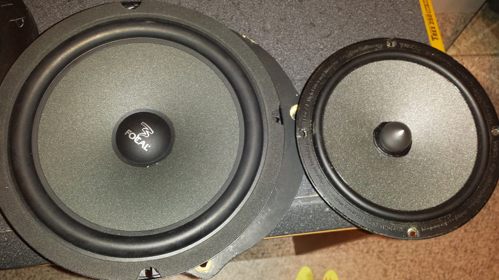

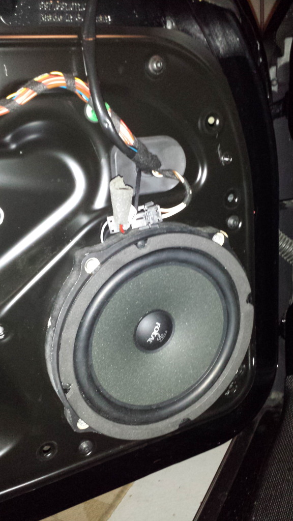

Door woofer conversion
So, just spent three hours upgrading the door woofers from 6.5s to 8s. That was as efficient as possible really, but also included modifying the spacers to accommodate the new speakers. In the meantime, also found that the midranges were not secured well enough - make sure they have a nice seal to the doors.
I was getting very good performance from the 6.5s, anyone wants them, let me know. The IS200's were just not available at a decent price at the time (would have saved me money just to pony up in the end, ah well). You can see there is quite a difference in size. Stated response is 40hz versus 60hz, so these babies should go much lower. Initially they sound a bit muddy, but that's not a surprise, they'll need to break in.
One installation tip. The small cap behind the door handle. The Rennlist thread recommends using a razor blade. DON'T! The hot tip? Just push firmly on the bottom of it. Pops right out. No problem.
Wow, this thread is going to need an index - we're up to 21 pages! Anyone wants to pass on rep points, feel free!
Some pics of the install:

Totally running stock PCM and the Bose amp. For signal I'm feeding uncompressed music files from my ipod through a NavTV unit into the PCM.
The power from the Bose amp will surprise you. It has stunned me, frankly.
Not sure what you mean by current change or what hertz energy tweeters are, but they are probably less efficient than the center speaker. Disconnecting the center is easy and the sound should be much improved.
The choice of the focal integrations was because it seemed a popular, quality choice and the speaker is engineered to be a drop in replacement as they have built in crossovers. External crossovers will provide better sound, but may need new wiring and can introduce hum.
So, are your doors still intact with the 8's? Hahaha. The 8's can really rattle the doors. Mine should be fully broken-in and I'm fully contented.
Question about the subwoofer: do you think I will have better subwoofer performance if I were to invert the subs? In other words, the cones will be facing the roof. Obviously, I will need to cut the carpet.
No kidding! The bass output with the 8s in addition to the sub is really good. The sub is a touch muddy, but there is certainly plenty of bass. I think the 8s will get snappier after they're broken in - mine are only in the early stages.
I wouldn't do that. It would be more than cutting the carpet as the panel below would need to be relieved somehow. Also, you are effectively reversing the polarity of the sub speakers and would thereby have a canceling effect with the fronts.
If you die to experiment, buy the 5.25" JL Audio drivers and drop them in. Two will run you $320. I suspect they will improve the bass quality. Go for it!
