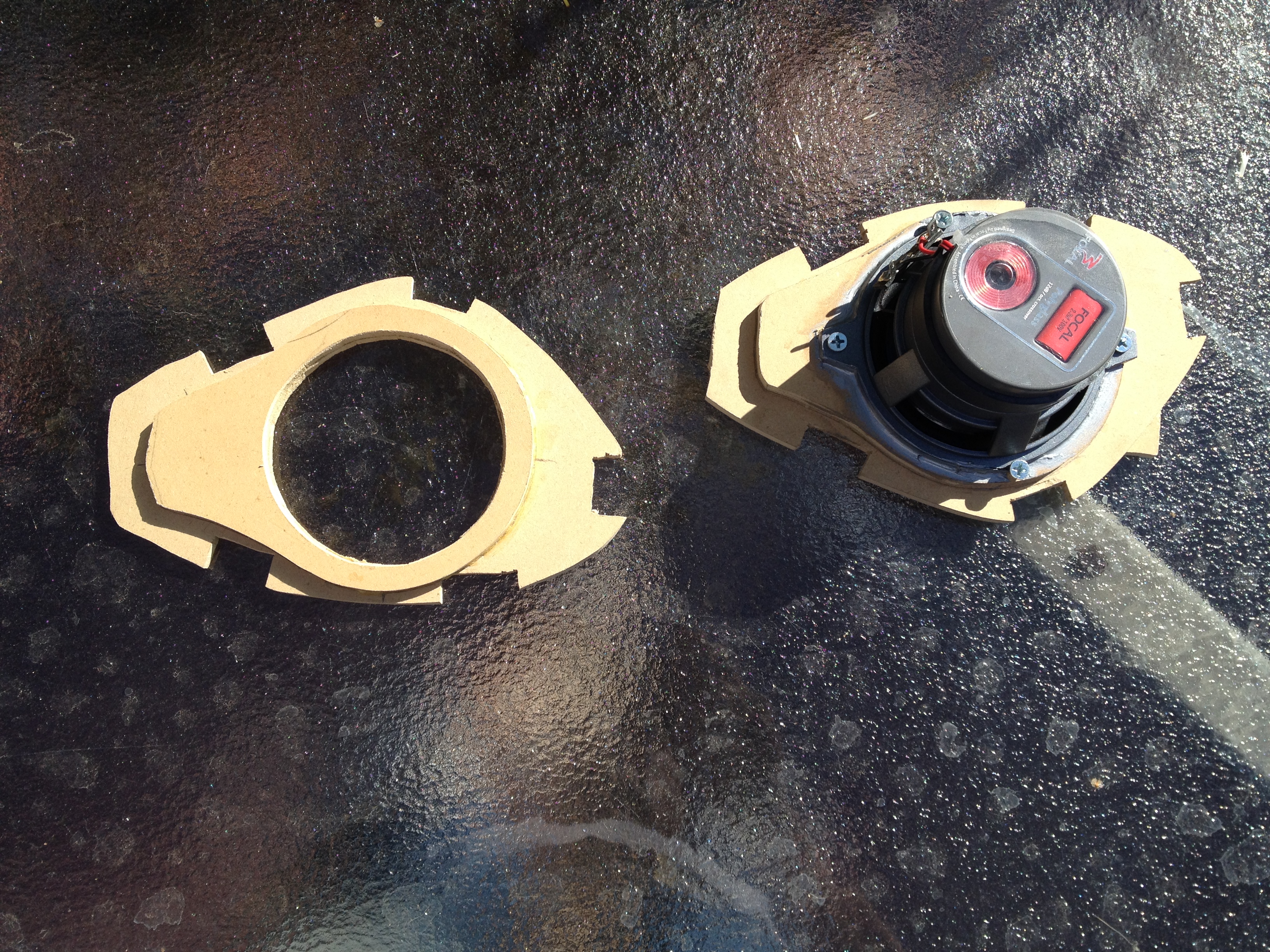

Well, here are my pics. The rears were top-mounted with the plate --- they basically just slide into the hole. No panel removal is needed.
Due to the weight of the Focals, I designed the plate so that the plates' inner smaller piece will use the mounting hole as a "cradle".

Nicely done! How thin are the outer panels? Do they interfere with the covers? What is the material? Good solution.

Material is 1/4" high grade MDF. I have extra laying around in the garage. No interference.
