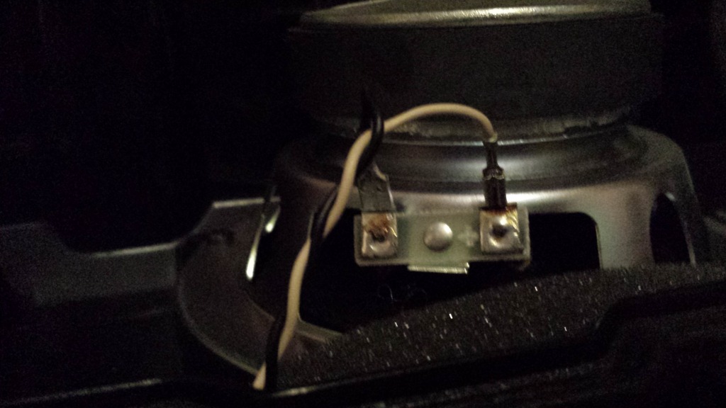

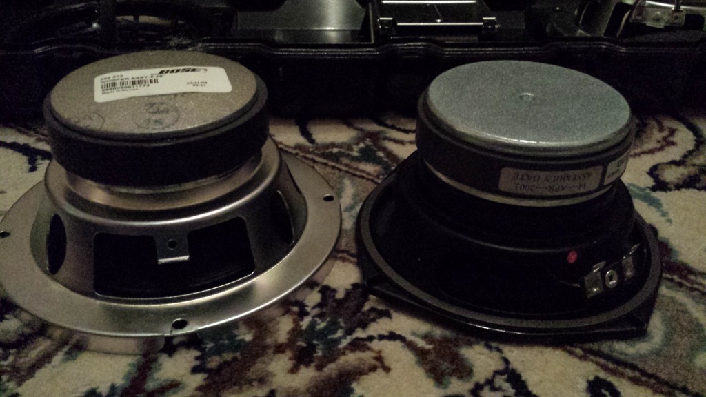

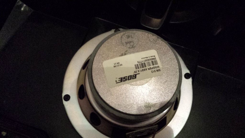

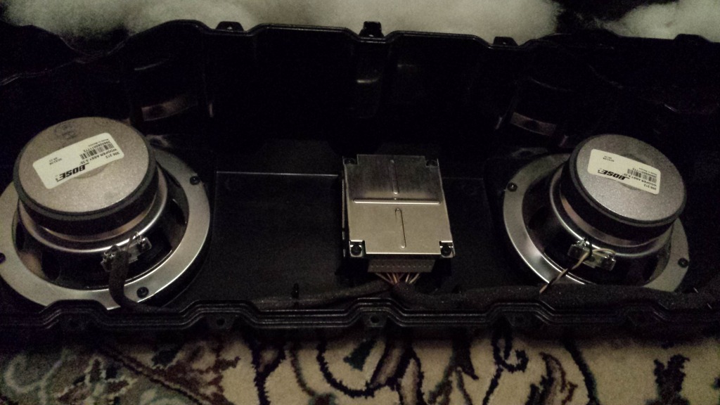

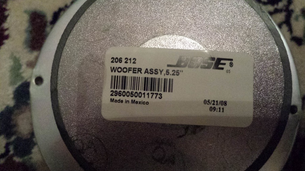

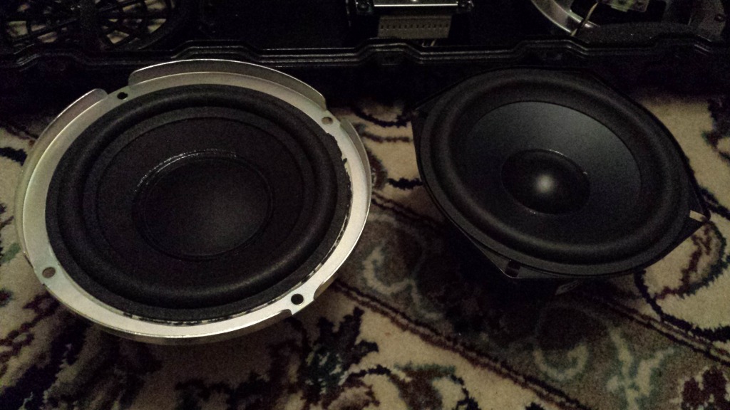

subwoofer details
So guys, I've done a little digging into the Bose subwoofer. I bought a set of cheap Polk Audio 5.25" speakers to replace the stock Bose drivers. Reality is the Bose sub drivers seem pretty decent. They have pretty large voice coils and decent magnets. The Polk speakers had the same size magnets and smaller voice coils - swapping them in seemed like it would be a DOWN grade, so I aborted the swap. Similarly, the expensive JL Audio 5.25" drivers have smaller voice coils, for $320 I'm not sure they would be much of an upgrade either. I'm going to go with swapping out my 6.5" door speakers for 8" ones. Listed frequency range goes from 60hz to 40 hz, should be a noticeable improvement in bass of the whole system. I realize a couple of you have already made the choice for the 8's, I think that was the right call.
In some ways, I'm not sure why I'm intent on continuing to upgrade. In its current form, the system sounds VERY good. On rock, it gets REALLY loud. I think the 8's will take it up that final notch though. I'll be able to update and let you know the magnitude of the improvement when I get them in.
Pics of the inside of the Bose sub and a comparison with the Polk drivers I checked out. Also note the ODD sub driver polarities - the large spades are NEGATIVE.

Interesting!
So, looking at the label, the rear unit is actually a woofer and NOT a SUBWOOFER.
Thanks for the pics. Btw, I wonder if there's enough box volume and room to replace those 2 woofers with one Subwoofer!

Well, they are pretty much sub drivers, even though they are not that big.

Bose speaker polarity check
So, to continue info sharing, I've triple checked the polarity of all the speakers. ALL of the speakers are negative on the striped wire, positive on the plain wire. The 8" door woofers are positive on the large spade, negative on the small spade. I'm confident my entire set is polarity correct. Difficult to verify the tweeters with a standard polarity test, but if the wires are consistent with the rear panel speakers and the door midranges, then they are also negative on the striped wire. Anxious to hear more results from others.
