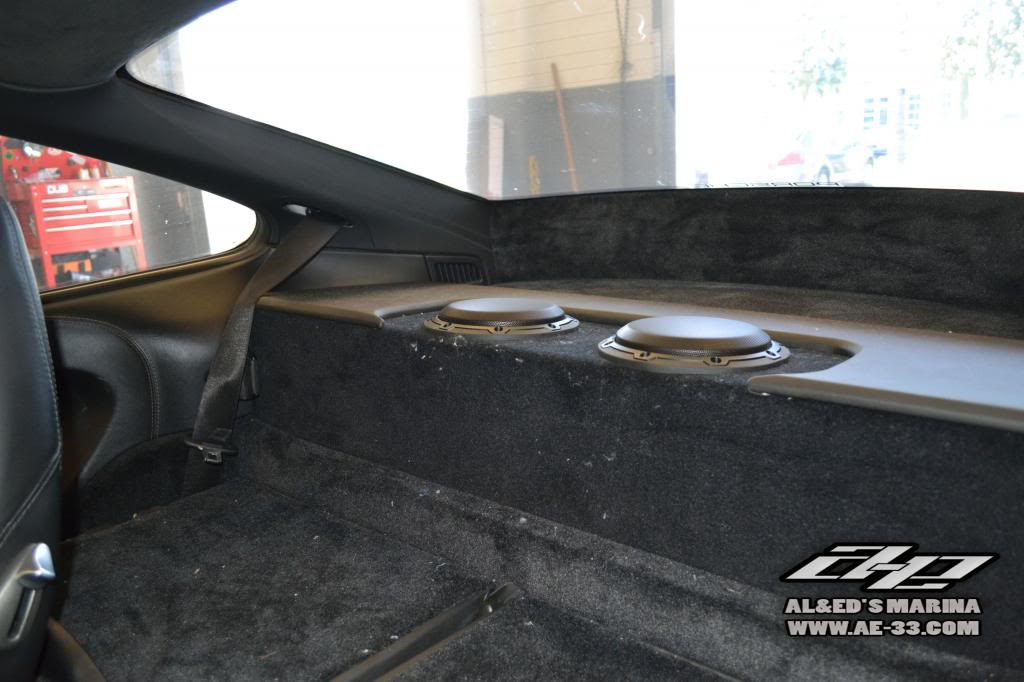

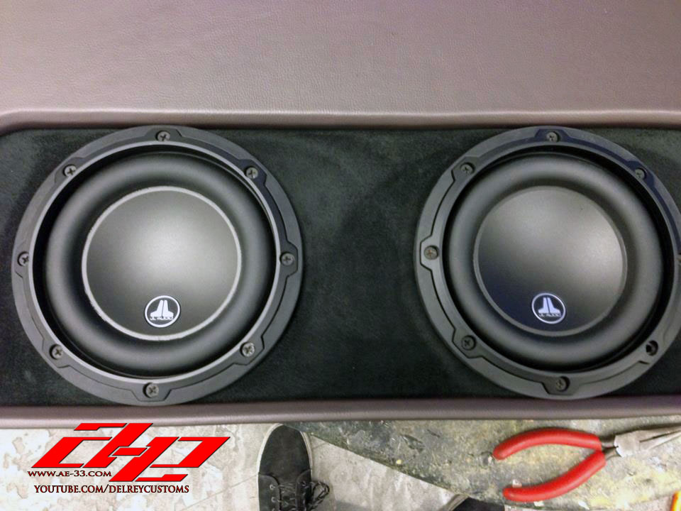

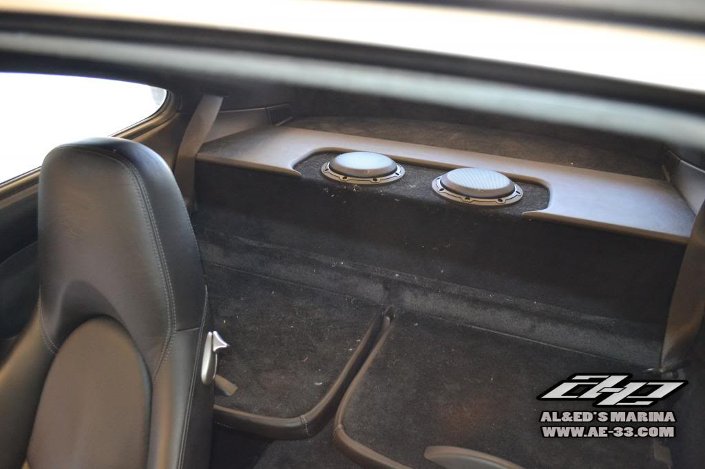

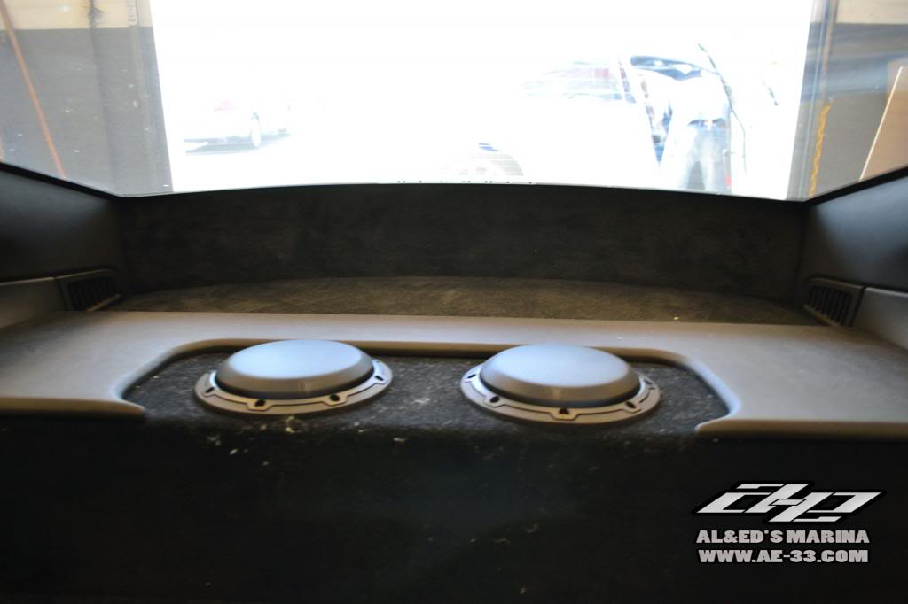

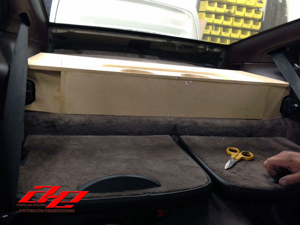

i have an oem replacement box same shape and size with 2 jl audio 6 inch 6w3v3-4 thats a monster. jl audio xd300.1 perfect power amp first under pass seat.
package is 899.99 includes all wires and cables..
the 8 you have to change the oe foot print and it doesn't look well.
ill post it on the webstore as well
i would do 2 8 but the look isn't there and a wood box sounds way better than fiberglass.

Oh right, I remember that. Looks good, but also looks crazy heavy with all that MDF.
Why do you say wood sounds better than fiberglass? Properly done they should sound identical, but fiberglass is definitely trickier to form and get rigid enough.

fiberglass has to be moulded to each car or a mould need to be created
wood we can template and know out as we need
production time on fiberglass is 3-5 days and we need the car
wood production time 3-5 hours and we dont need the car
also by the time you reinforce fiberglass to get it to the density of wood and finish it up they weigh about the same
MDF is the best for projecting sound and it very acoustical which you want good acoustics for bass. fiberglass is sensitive tho heat and flex and air pockets.
a fiberglass box with material cost would drive the cost up.
we don't always agree on everything secertasianman but i do respect your opinions,

Regardless of how we agree on things, if you have the right product I'll happily hand over the $$$ It is not personal. I have a low tolerance for "salesmanship".
Very good point about needing to hold onto the car.. I was hoping someone would build a mold. Fiberglass is definitely a PITA. I have never worked personally on it, but managed projects where I had guys building fiberglass components for me.
Properly done, fiberglass boxes of equivalent acoustics and rigidity will weigh *much* less. Fiberglass has a tensile modulus about 4.5x that of MDF. Most audio shops will lay fiberglass mat over the space to fill, then rig up an MDF frame/sub ring, stretch felt over the whole thing to resin, then apply fiberglass mat/resin over that. This is a good way to fill an odd shaped space, but honestly is pretty ghetto as far as composite laying goes - this will definitely yield a heavy and weak box (as far as fiberglass goes).
Doing fiberglass "properly" is very hard and requires pretty specialized skills/knowledge and tools. Not practical for your average shop to do things like this. Think about it, if MDF was just as strong/light as fiberglass or other composites, why would we use composites for hoods/fenders/doors on high end cars? I don't see a whole lot of Ferraris and Bugattis sporting body panels made of wood.
Anyways, it would be good to hear more details about your box. I'm not sure it's for me, but I would be curious to know 1. fully loaded how much does it weigh and 2. does it have an integrated amp so it's a plug & play replacement for the Bose?
