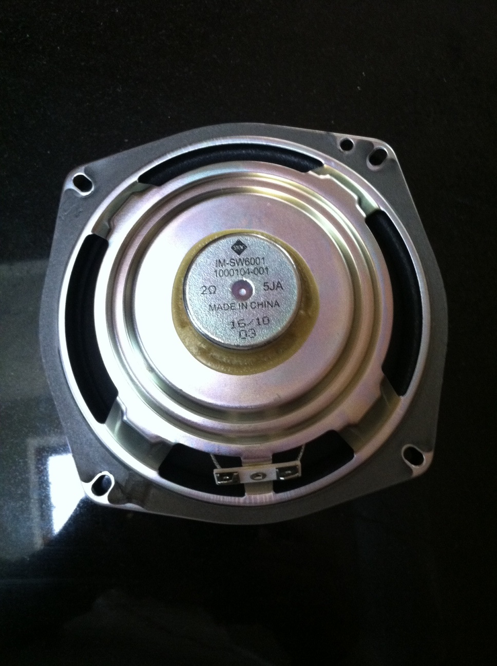

Originally Posted by Bruce in Philly
Some science..... someone has some bad numbers.
I've replaced Bose bass drivers in two of my Audis (2 woofers in an old A4, and 1 "subwoofer" of laughingly low quality in my current Q5) and both were spec'ed at 2 ohms. Just sayin'.
(Photo attached for reference.)

That's why the new 4 ohm Focals in the Bose system ROCK!
