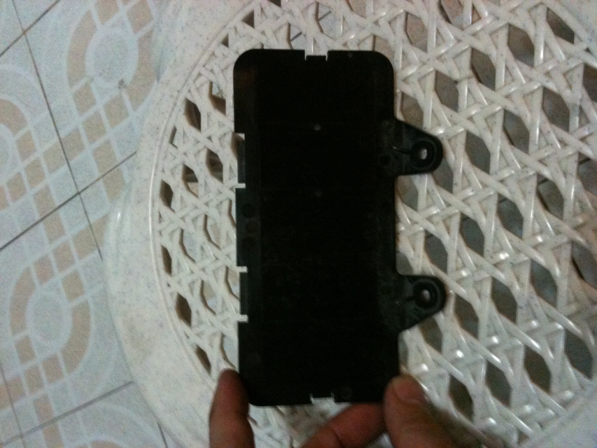

I replaced my air filter recently and saw 2 removable panels in and air filter box. The panels were made of plastic similar to the rest of the airbox. I read more on the tech information sheet and there is suppose to be panels made of polyaramid that lets sound out but not let heat into the box. If these panels were available im sure this would improve my intake sound! The part number of the panels in my box now is 997 110 240 30. I wonder if the panels made of polyamide are available... Have you checked you air box panels?

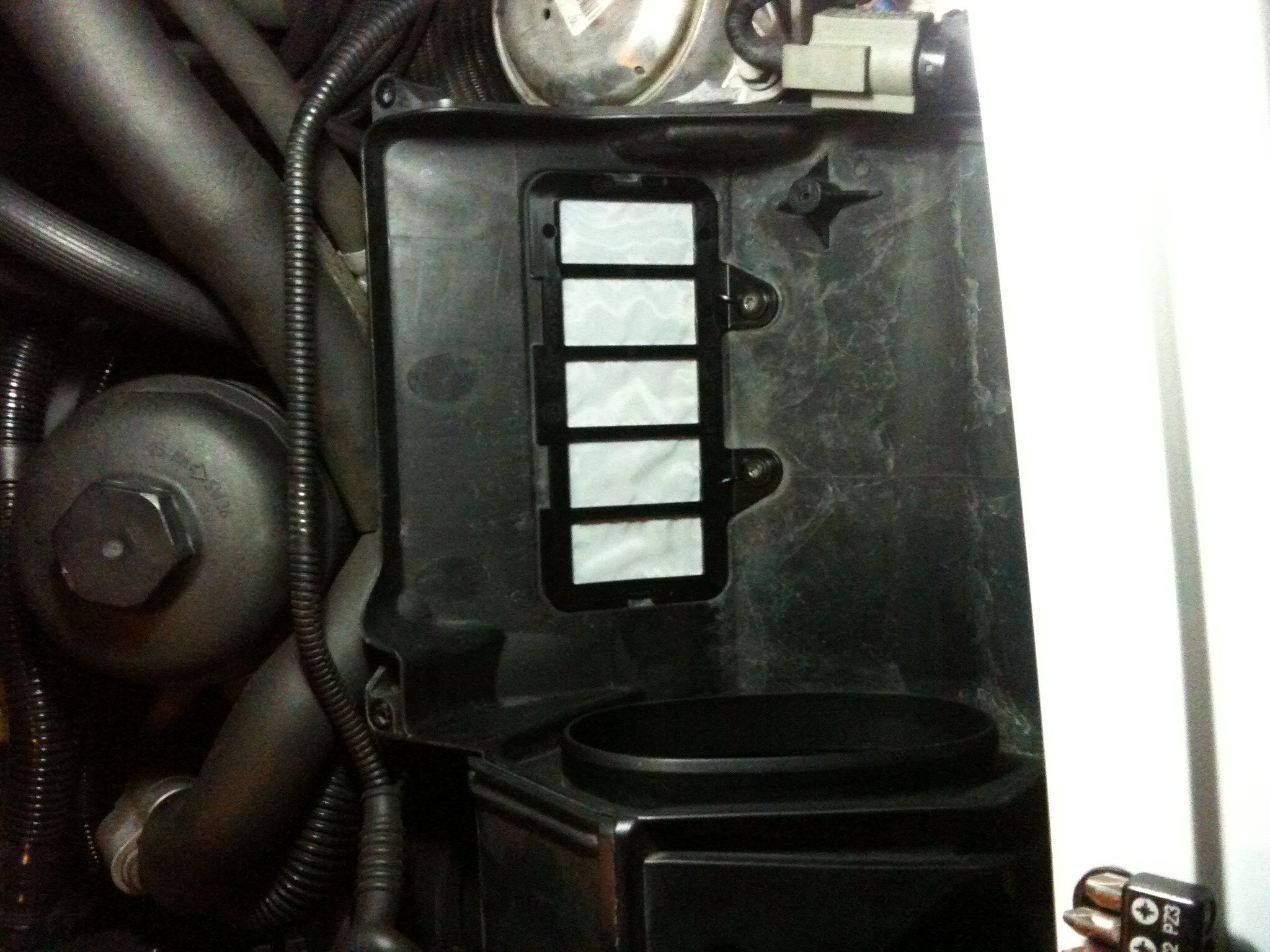

Ok there is update to this one. The panels arrived and i installed them. From the way it looks the panels should let more intake sound out of the box. I do not know why my car did not have the screens in the first place but im pretty sure seeing the panels i replaced this will sound good when im pushing it.
Here is a picture of the new screen panel installed. There is one per side of the air box

mine have always been there just like those.

Here are some more pics of the panel i replaced and the part number of the panel with the screens. Check your cars if you have the solid plastic panels or the ones with the screen. This should be a good upgrade if you have the plain plastic ones like i did.

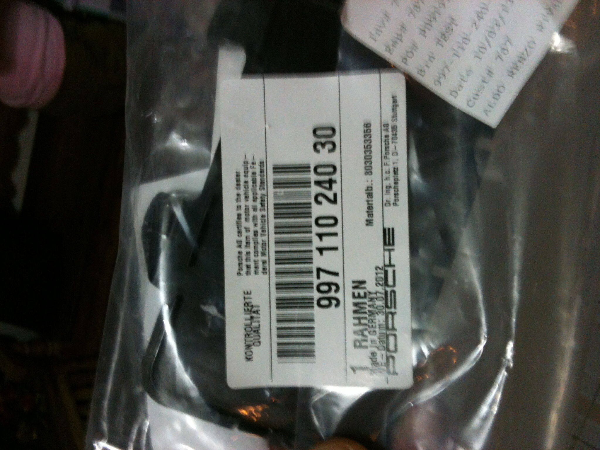

Part number of panel with the screen

Hey cerbo, thats good maybe you can guide me if you have two screen panels or just on one side? Is it on the drivers side or passenger side of the airbox or both sides. Thanks brother.

both..... I just took them out and washed them off last month when I replaced my air filters....

Great. Ok brothers...check your air filter boxes.. If you have the screen ones then your good to go, if not then there is a cheap way to increase intake music....replace the plastic panels with the screen ones! And according to our brother cerbo, you need to replace both sides!
