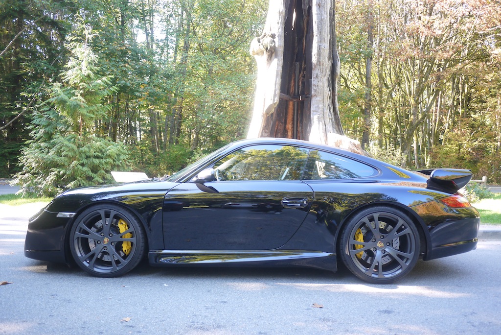

awesome job on the wheels. looks sinister!
Originally Posted by Austex911
Thanks. I used black plasti-dip followed by 3 coats of silver metallizer to give the wheels a gunmetal finish.
I purchased the front bumper from another board member about 2 years ago and he couldn't remember who made it, so I am not sure what brand it is.

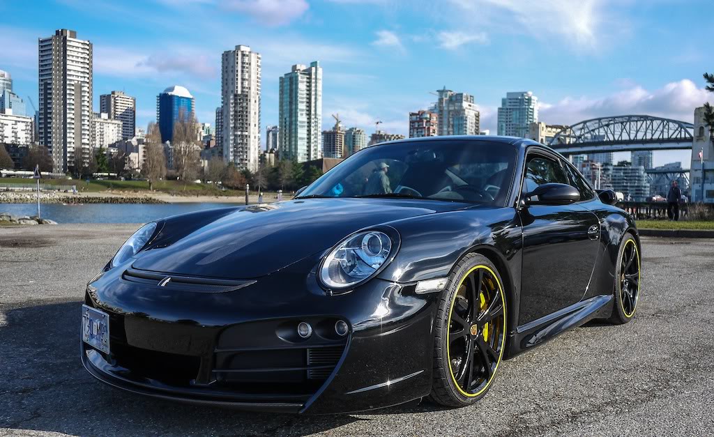

Looks great. I was thinking of doing that to my stock lobster wheels. What kind of lowering springs do you have? Perfect height.

I didn't remove the tires from the rims, but I did remove the wheels and tires from the car and used index cards to avoid getting plasti-dip on the tires. I used 3 coats of black plasti-dip followed by 3 coats of plasti-dip silver metallizer. You can only order the metallizer from dipyourcar.com.

just dipped my wheels this weekend - anthracite grey with a couple coats of glossifier. I didn't remove the wheels from the car, just covered the rotors with plastic and masked the lugs. Turned out pretty good... my wheels (see last pic) are shiny black Techart forged 20's with a painted yellow stripe on the edges. Not everyone's cup of tea but the nice thing about Plastidip is I could change it easily and go back to the original colour just by peeling the stuff off whenever I want. Or change the colour again... might do gold next!
I also dipped my rear 911 badge the same grey. And I don't have a hood crest but sprayed one monochromatic grey and stuck it on with masking tape just to see what it would look like. Not sure I like it with my exposed carbon stripes... still deciding on that one.

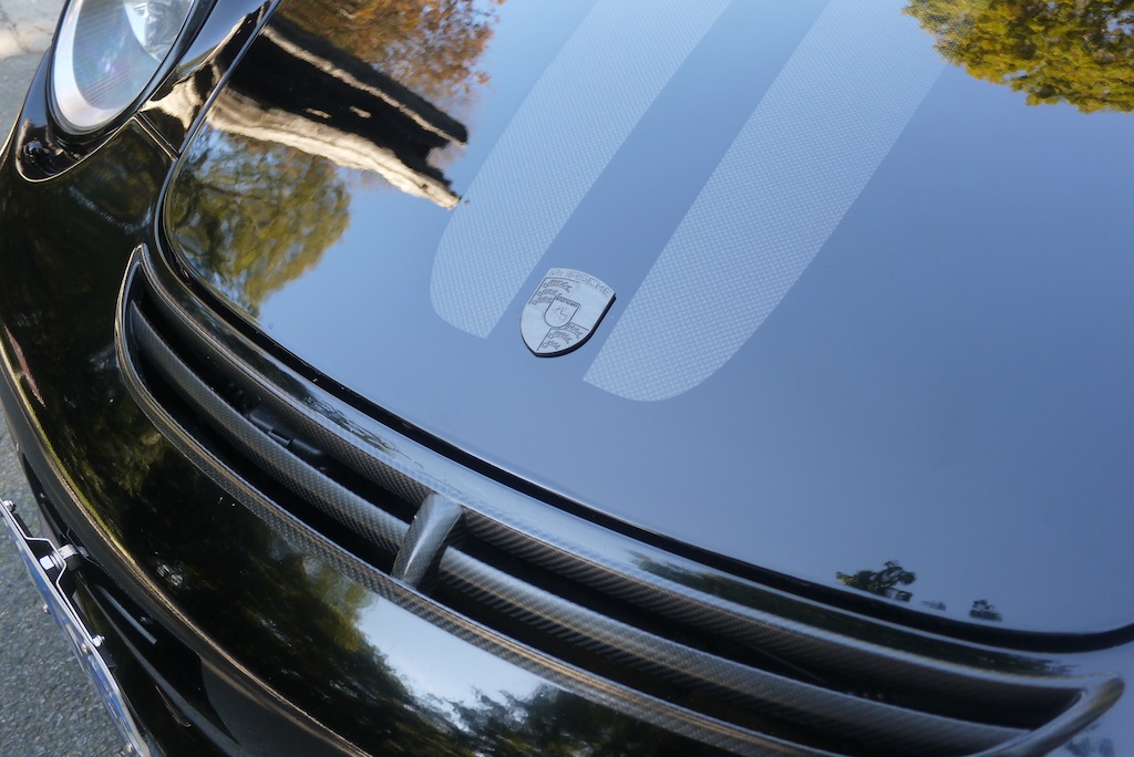

That looks sick!!! I love the carbon stripes. Mind telling me where got them from?

The car is lowered about 1.2" on Eibach Springs.

do it!! I did mine in Anthracite Grey Metallic with 2 coats of gloss plus H&R Drop!
Nice job Forsa!!! I like them a lot! Pretty much the same finish as mine. Let us know if you do the Vintage Gold! A friend of mine did his black VW CC with custom wheels in VG - lemme see if I can find some pics!

Romysc4s - those are not stick on stripes... my hood is all carbon fiber painted black but with the two stripes exposed/not painted.
