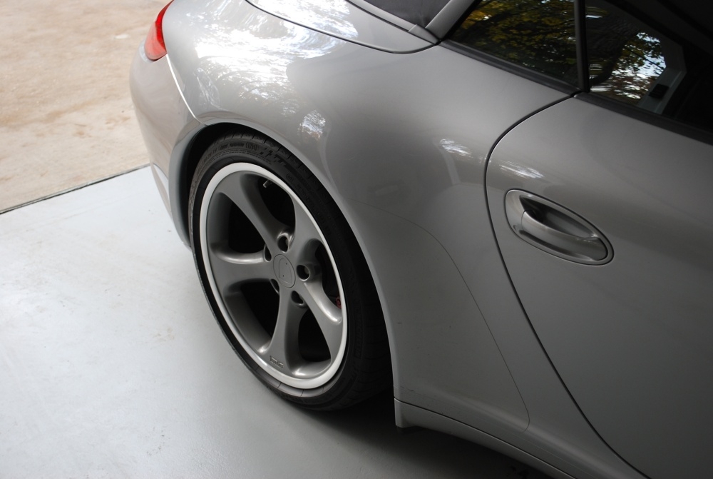

Nothing wrong w/spacing out to where ever you want the wheel to sit.
I actually run 8 1/2J 18s all around in the winter (wife's C4S) spaced out to look just like her summer TechArt 19s......18s here in the pic.

Great, thanks for the valuable info 911cv and Gregg! It's true that I'd rather have Porsche wheels, and knowing that 18 x 8.5s work is great. Appreciate the link to the calculator as well. Will let you know what I wind up with!

I actually like those 18s!! Sort of looks like RUF wheels. Nicely done.

Appreciate the kind words......as a point ref here are summer 19s.....Techart GT's which, of course, out of the box have black centers and machined/polished lips. Both sets were custom painted to compliment car. BTW, not car color, but rather to compliment GT Silver w/Stone Grey top. The car was done up just to be a pretty Pcar, nothing harsh....she'll never be tracked, was an anniversary gift for the wife a few yrs back..
