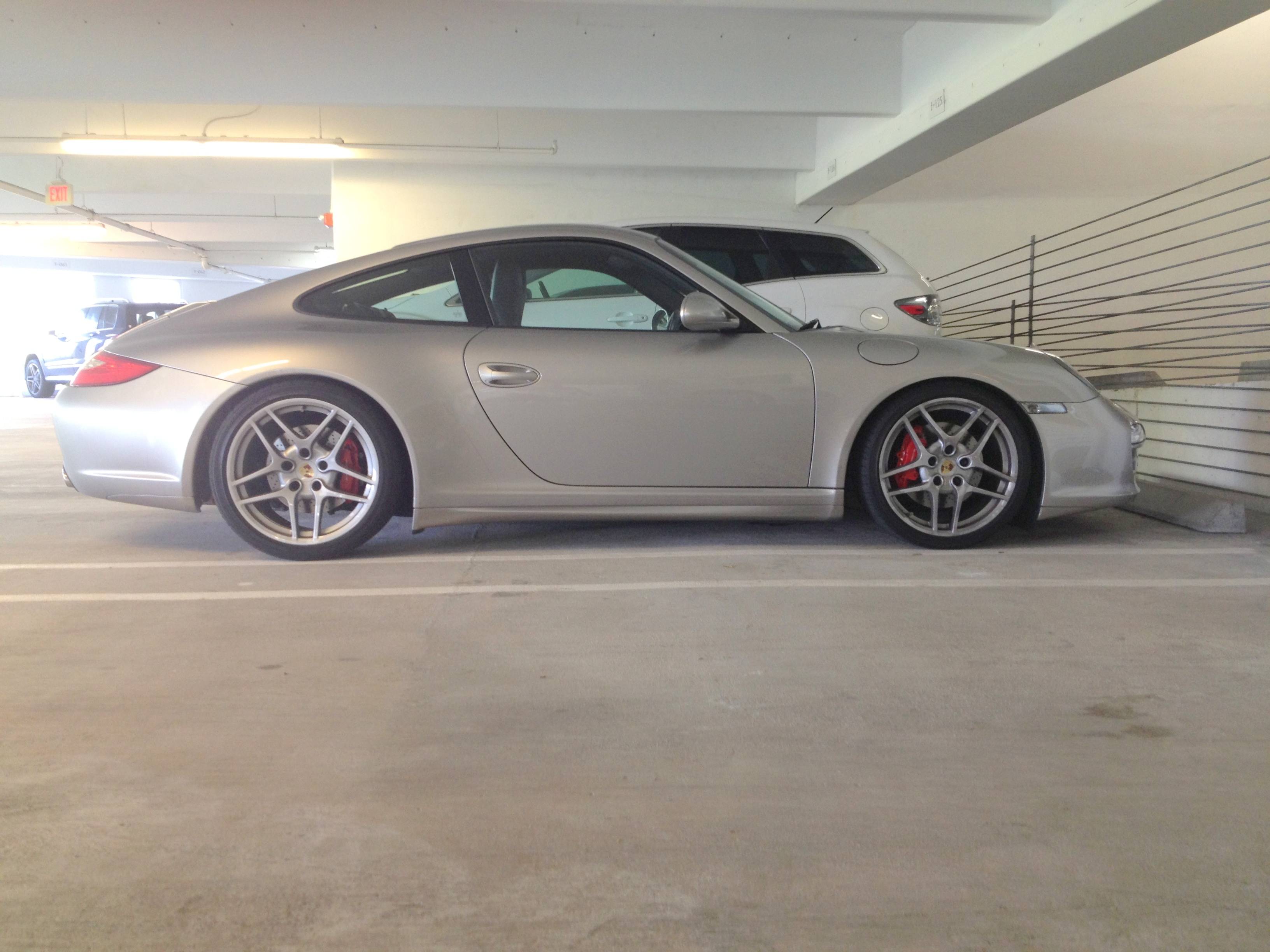

On the other hand, forum member "sandwedge" was kind enough to sent me pictures of his 997.2 C4S which is identical to my car, and you can tell the drop was more than 1". "Sandwedge" also told me that the drop in his car was considerable and that the gap is almost gone.
Could it be that H&R is being conservative in his numbers?
Has anyone done this mod in a 997.2 with PASM and care to share the drop results?
This is 'sandwedge" car with H&R springs

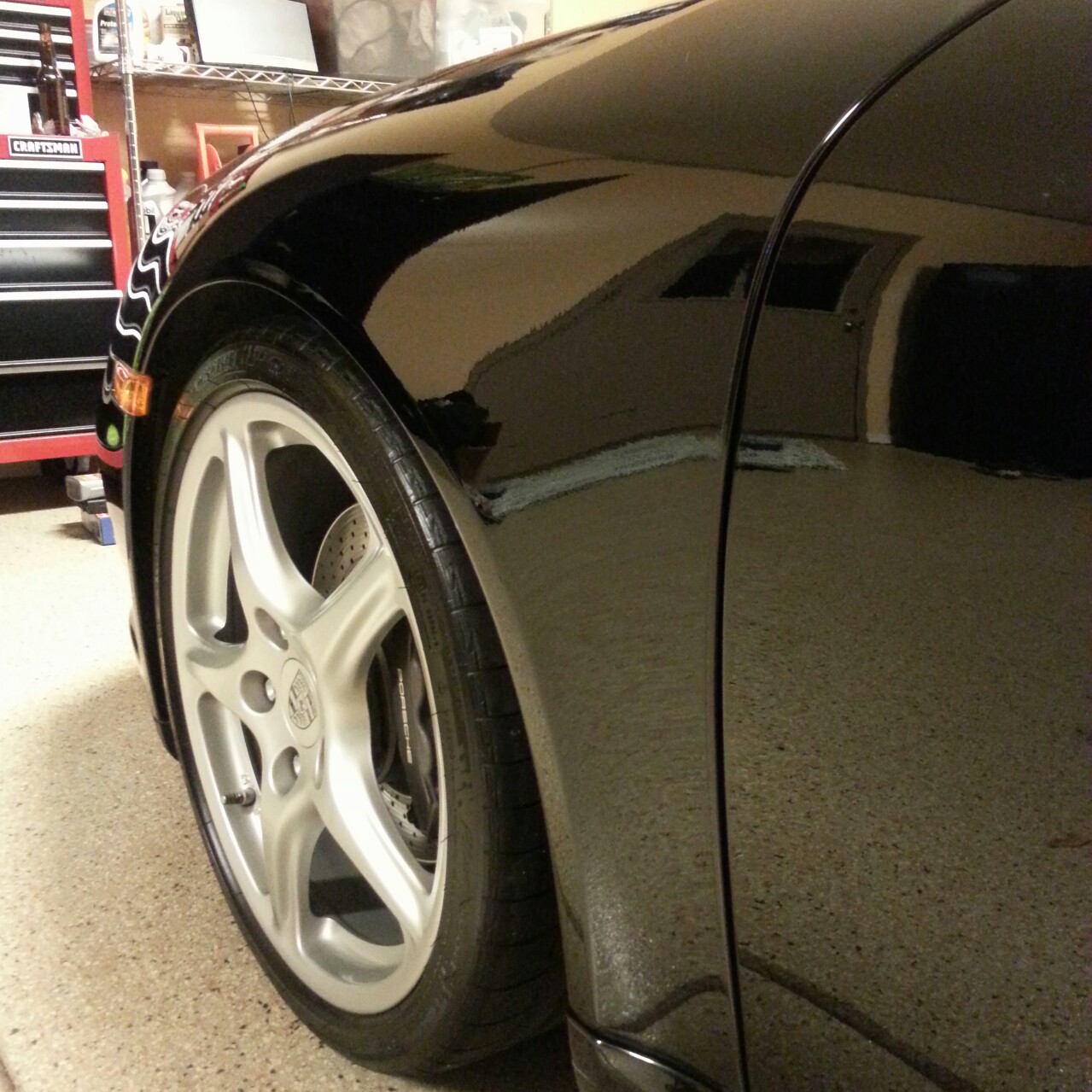

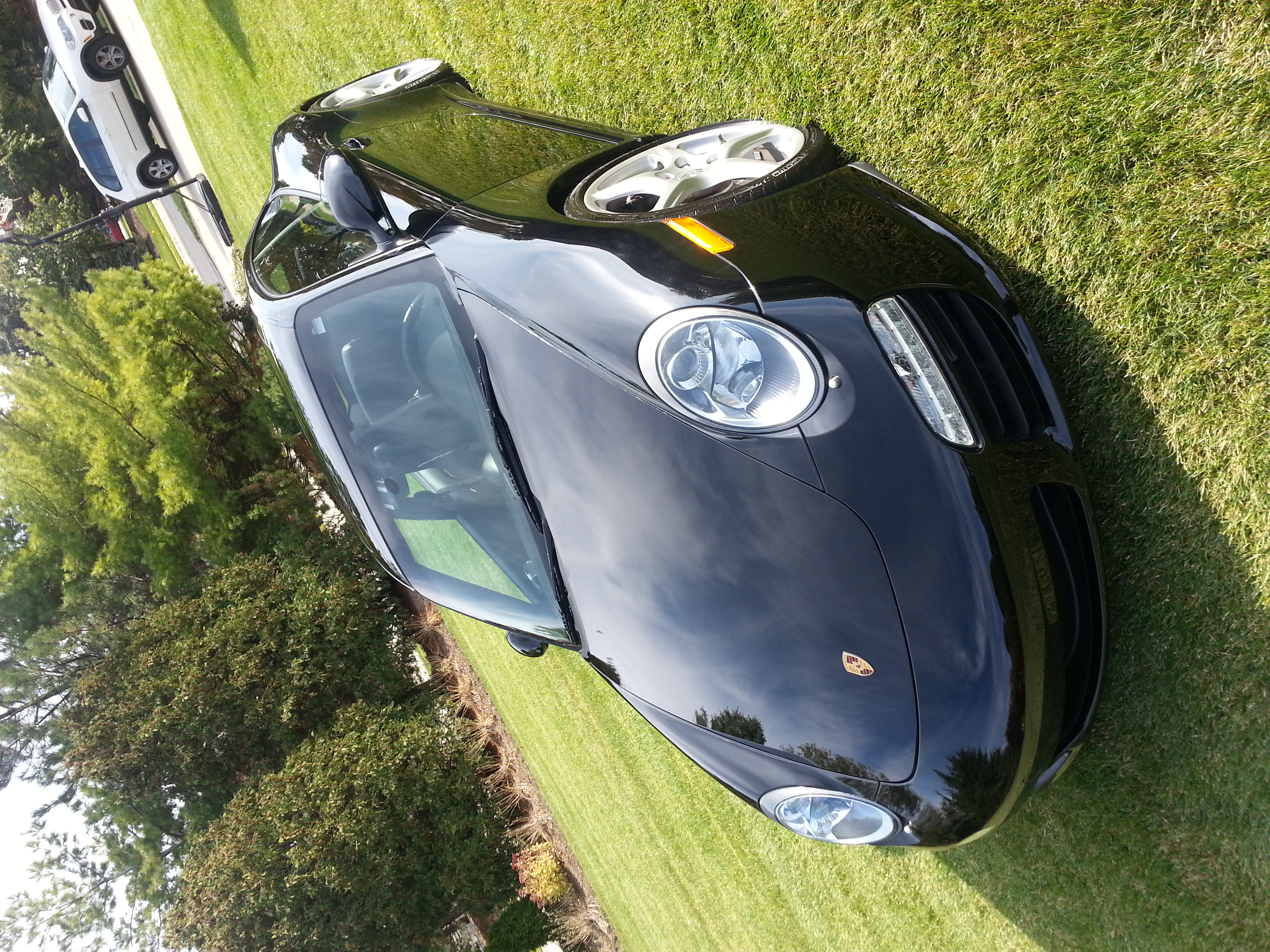

I have a 997.1 with PASM, fender gap is almost completely gone, I'm happy with it.
Uploaded with ImageShack.com

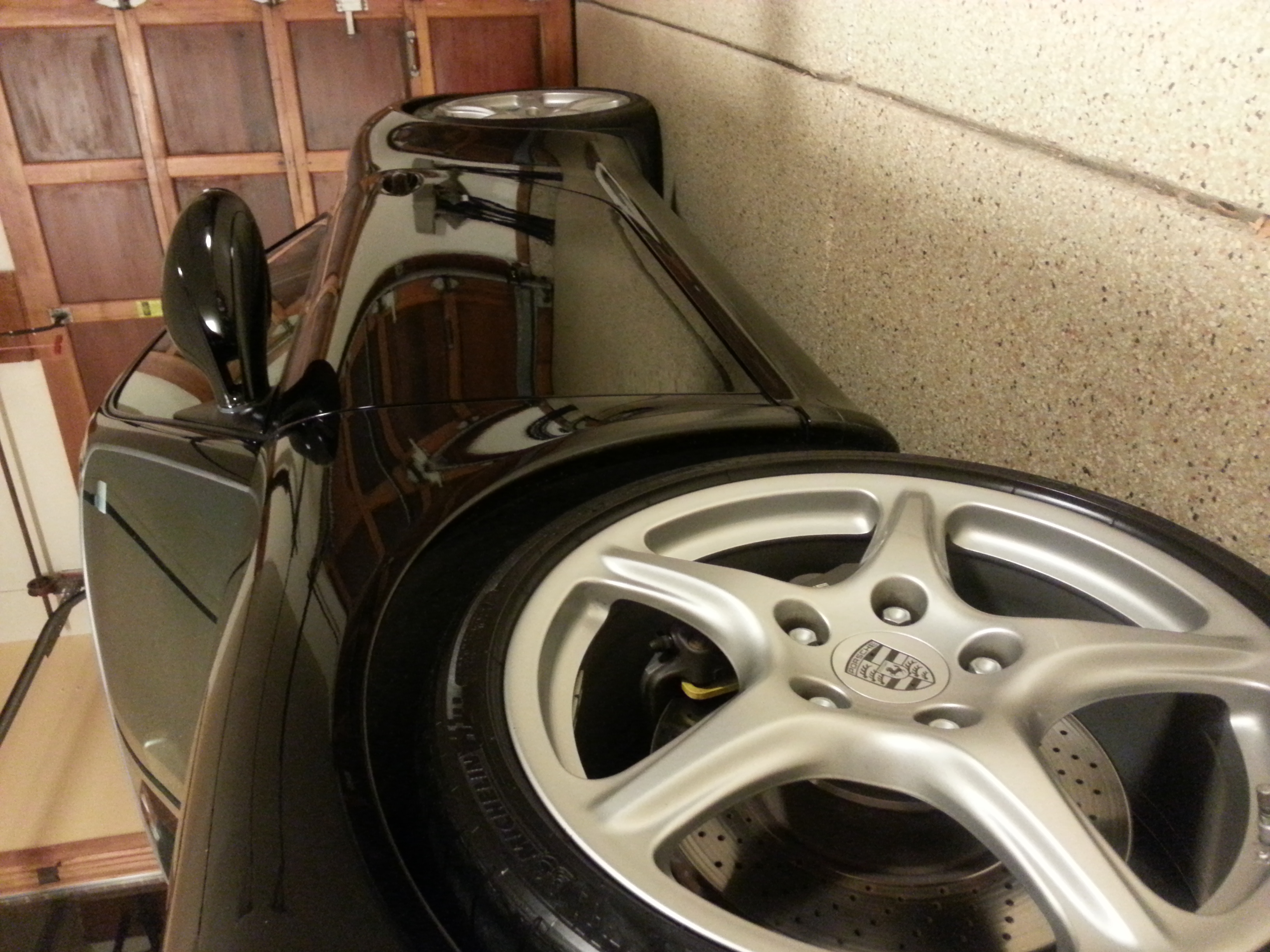

I finally lowered the car with H&R springs. It is a 2012 997.2 C4S.
The OEM height of the fenders were 26.75" front and 27.5" rear. The final drop was 1" front and 1.2" in the rear. I am very satisfied with the aesthetic results. The ride is just a little bit harsher but no more. The car seems more stable than before.
I hope this info help others who are in the fence regarding the H&R springs

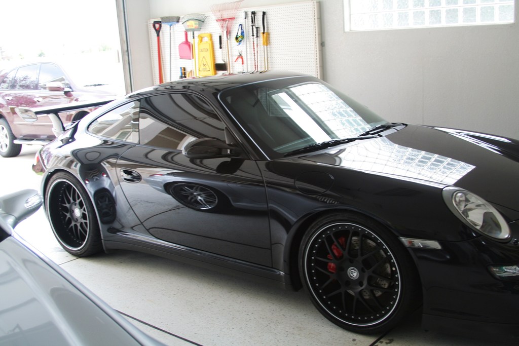

KWV3 and H&R 7/15 combo. Just right imo
